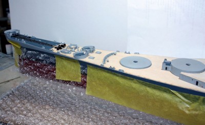

Jim, I slowly getting my Tamiya Missouri to the stage as I have to do the antenna rigging and flag halyards. I want to use your method. What do you do for insulators and turnbuckles? Also, when you substitute for metal masts, what do you do for all of the other structures that surround them? As I get deeper into the details of the WWII Iowas, I see that these "simple" masts have lots of stuff holding them up, e.g., angular braces, Forestays and backstays, etc. These are hard to fasten to metal masts (I think). Here's a shot of the ship as of today's session.
I'm modeling the ship at the end of WWII as it was on the trip back to Pearl. The teak had been returned to natural wood and the 20mm tubs were already removed abreast of turret 2. John at Scaledecks cut these so that tub was gone. The horizontal metal surfaces remained 20B deck blue. I wanted the wood decks to show, but also wanted most of the WWII weapons configuration and this specific time period allowed that.
It has Scaledecks Maple decks, ABER brass main guns, steel prop shafts, and the Eduard Missouri set. I really need to make a second one to incorporate all the learnings from this one. I've also added as many vertical and angular supports as practical on the overhanging tubs. I scratchbuilt the boat davit winches which lie foreward of the ship's boats P & S.
Today, I built the first MK38 radar set. Eduard is very accurate and very, very delicate. I actually have two complete sets to make one complete ship. Eduard etches where the bends go. Very convenient, but the etching reduces the cross-section so much that the parts often disassmble themselves at these points. It's exasperating! With the second set of PE that Eduard sent, I'm replacing some of the railings that have taken the most beating. I've covered the stand and hull with protection so I can work on the upper works without messing up a finished surface.

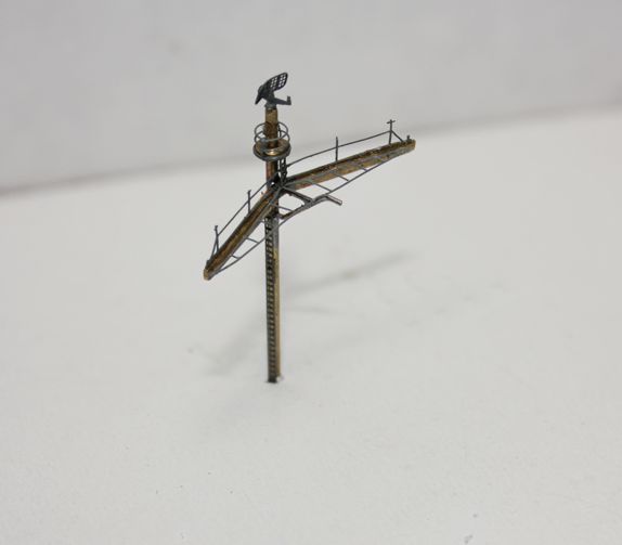

Here's the masting for the Missouri completed in brass. I didn't take your advice and use stainless, but the brass is pretty stiff. How do you suggest attaching stretched sprue to the metal? Note: I used some 0.008" piano wire under the main yard to simulate the trolley rig where the upper end of the flag halyards belay. I want to use your method of White Glue blobs to simulate the blocks for the halyard pairs. I'm also using the piano wire for the mast stays.
I'm about a week away from starting the rigging process. In the picture of the main mast... it's just sitting there for the beauty shot. I'm going to airbrush it off the model before installation.

All of the mast parts were either soldered, CA'd or epoxied with J-B Weld. I need a resistance soldering unit if I want to entirely solder these complex assemblies. As it is, the proximity of parts to one another makes it very tricky to solder one piece without the next falling off. Even using solder of different melting points didn't help much (a little, but not much).
I used J-B Weld steel-filled epoxy to hold some of these components. While not a "traditional" modelling adhesive, it really works nicely even in very small quantities. This picture was taken just after it cured and before I cleaned up the joints.
