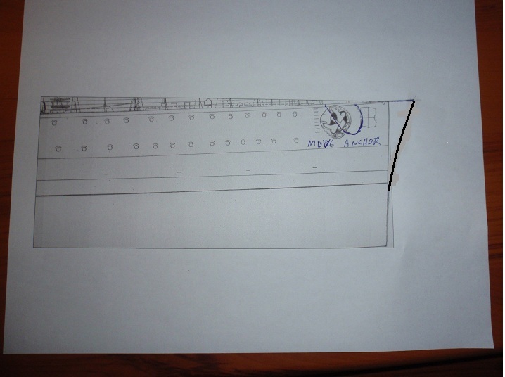

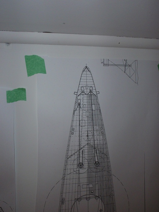

hi all, well i could'nt find any decent pics of the atlantic bow ,just some vague ones,so i reworked the graf spree drawing.i hope it is close. the anchor assembly,water brake,and capstans seem to be in differant spots. the adding of the bow adds 7 ft to real ships length 610 to 617 this is about 6/10" in 144.i am still not going to start cutting, have to make sure on the funnel and bridge,still have no drawings of these areas.if i can't find satifactory drawings and pics i will have to go with graf spree :heh: ,i have one plan still on order hopefully it will have what i need,but it is slow coming,more then likly because of christmas and new years.

are you sure about the bow´s profile at the top end?

good to hear from you norbert, bernt you are right that looks more like the bow of new jersy than s.c ,it should be more like this.
