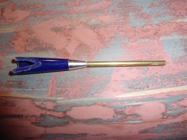

andrew it is simply amazing,how many times of filling and sanding it takes to get the hull fair.I am constructing the prop shaft tubes.I am a bit of a scronger when it comes to finding differant fittings and stuff, there is very little photo-etch or accesories in 1/144 .i spend a lot of time looking for things that look like the part i want to build,craft shops,dollar stores and the such.the prop shafts where right under my nose,ball point pens.i found two in the stash of pens that where out of ink,that matched up darn close to the real things,all i had to do was flaten one side to match the hull,redrill the hole to my shaft size and ,'bobs your uncle' it looked pretty good.i have two sets of plans but not one of them has the armor belt shown or plating,one shows it so high up that it covers the lower line of port holes.i know this is wrong,i have some pics showing the stern area ,but not the bow.i can fiqure out the length of it but the depth eludes me.any input on this would be very helpful.
File comment: this is the pen,trimed and drilled out to the shaft size
File comment: this is sytyrene that the shaft will slide onto
File comment: on the under side i gut a slot for the styrene to slide into
File comment: bondo putty great stuff
File comment: sanded down
File comment: done
