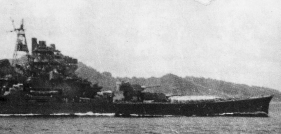

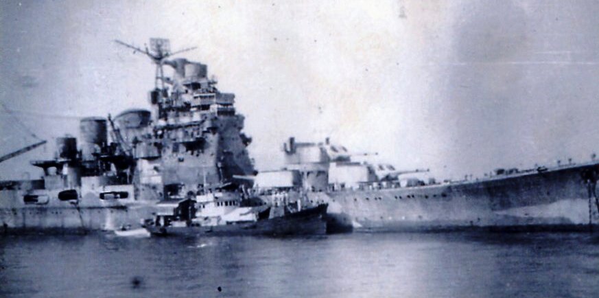

No overhangs - see this small Takao photos
Takao, postwar turrets.jpg (15.53 KiB) Viewed 2602 times
Atma
Posts: 3134
Location: Oslo, Norway
Post by Atma »
Oh thanks Dan, so Takao's and Atago's rangefinders on mumber 1# went the same treatment like the Myoko's class.And I see that the rangefinder windows on number 2# turret increased in size like Myoko class.Did Maya and Chokai didn't had any change at all on number 1# turret ?
Posts: 9117
Post by Dan K »

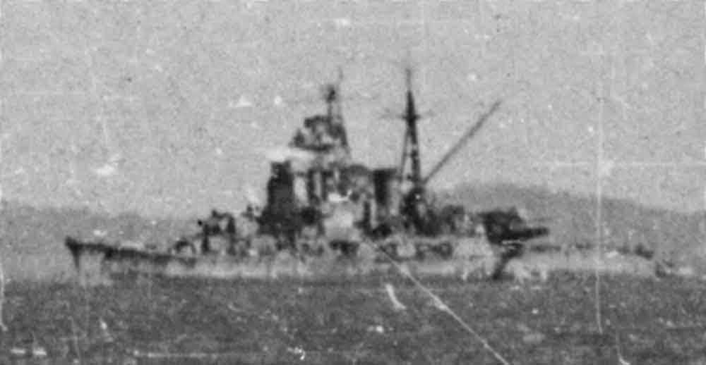

I'm just not sure by late war. Certainly, Chokai & Maya had them thru mid 1943. As I wrote above, L & W drawings make it seem like they were removed, and the housing shell minus the overhangs remain. It would make sense. The photos aren't clear enough. Maya at least retained the housing.
Atma
Posts: 3134
Post by Atma »
Yes I see, is hard to tell I never show a good/not blurry picture of Chokai after 1942, Maya too. Thanks Dan for your effort :)

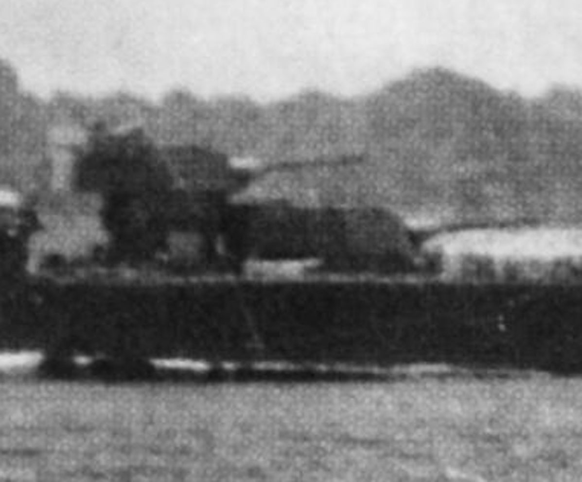

One last try at 400dpi. I think it's just a housing remnant on top of the turret.
Atma
Posts: 3134
Post by Atma »
Yes Im deffinetly sure is a housing remnat of the rangefinder there Dan. But as you said too, is hard to tell if the overhangs have been removed too.
