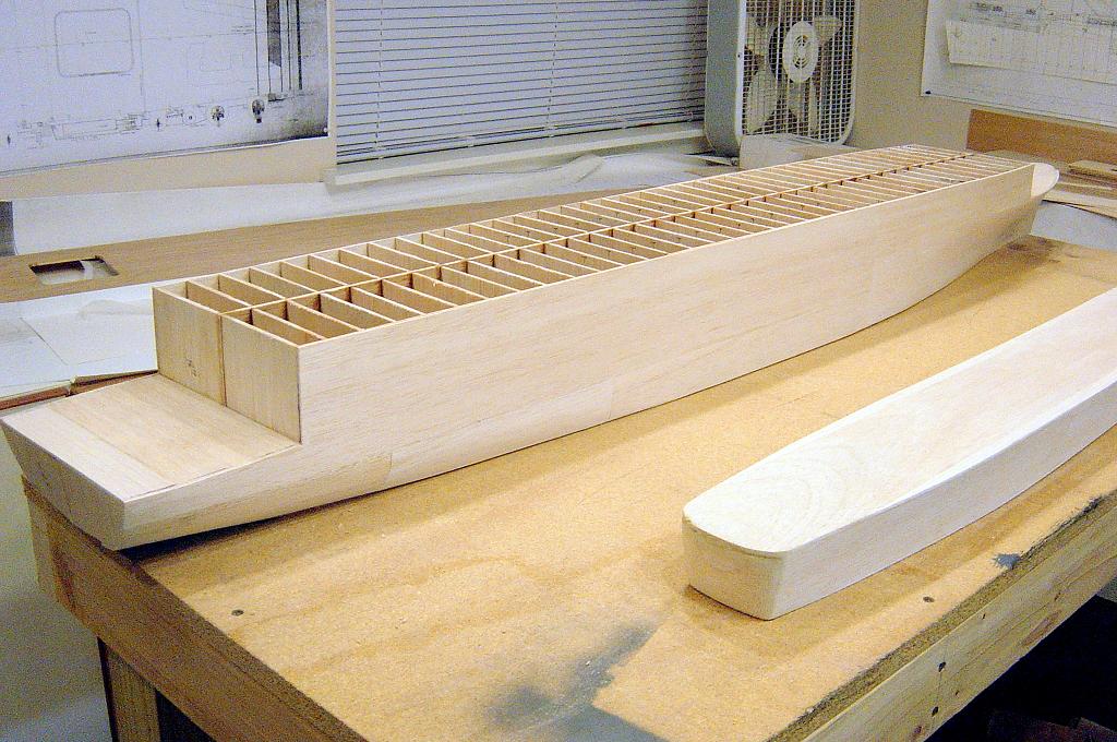

Hello again all :wave_1: Moving along on the project, I have now finished sheeting off the Carrier, and covered the DE framework. Lets take a look......
File comment: Portside bow view of the CVE. Note that the second layer of 1/16" sheeting really smooths things out. I'm able to make the joints alot tighter, too.
File comment: Portside stern view here. By using large sections of the sheeting, I can cover alot of area realativly quickly. Contact cement used here.
File comment: Midships, portside. Again note the tight joints between the sheets. This second layer also adds rigidity.
File comment: Port view of the DE. Covering this was a little different. Since the spacing on the hull sections was much greater than the CVE, I planked this first with 1/16" x 3/8" balsa strips. Then the second layer was added using the sheet goods. Deck is 1/8" hard balsa. Stern is rough shaped balsa block.
File comment: Portside fwd. of the DE-133. Note as I get closer to the very front of the bow, I reduce the sheeting size so the wood will bend easier without splitting.
File comment: Overall view portside of both hulls. The table is 25" wide. In the display when completed, the ships will be about 36" apart, center to center, to give more room for water effects.
File comment: Bow view of the DE. Note the piece of .040 styrene added here for the bow stem. I'll form this area with autobody filler using the styrene as a guide to get that nice sharp bow. Once finished, this will all blend in and you would never know it was there.
File comment: The CVE's bow is alot more blunt than the DE. That sharp edge does'nt start till just above the waterline. I'll use styrene here too for the stem, but the upper part of the bow is quite rounded, fat, if you will. Same procedure with the filler will be used.
File comment: Stb. side here. Again note that second layer of balsa sheet really smooths things out.
File comment: Another stb. side view.
File comment: Good study from stb. showing the size comparison of the two ships. The CVE is about 200 feet longer than the DE. About 2 feet in scale terms.
Next step will be to seal the wood with polyester resin, then sand,sand,sand. Stay tuned, more to come...I continue on.............. :wave_1: :thumbs_up_1:
