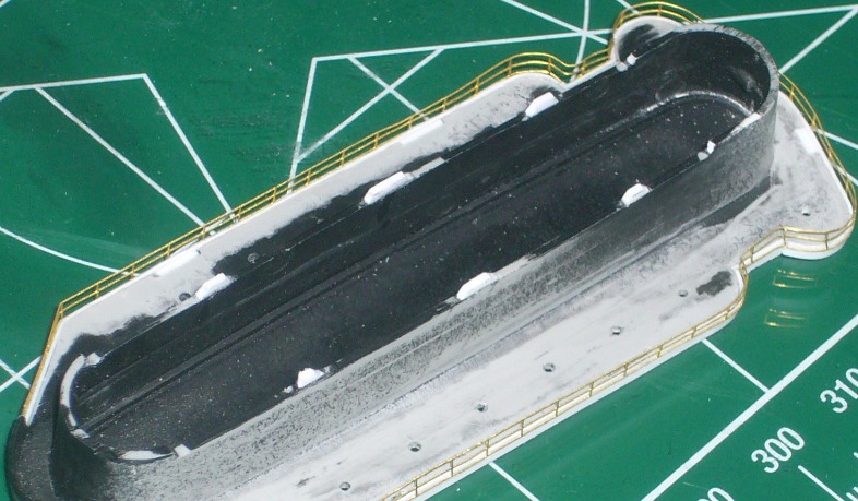

It seems as if computer access will be tight for awhile so I decided to post what I am doing and add pics when I can.
The first thing I did was paint the lower hull and with one coat it seems to be OK. It looks good but when I do the rest of it I will give it a second coat.
And now begin the pics.
