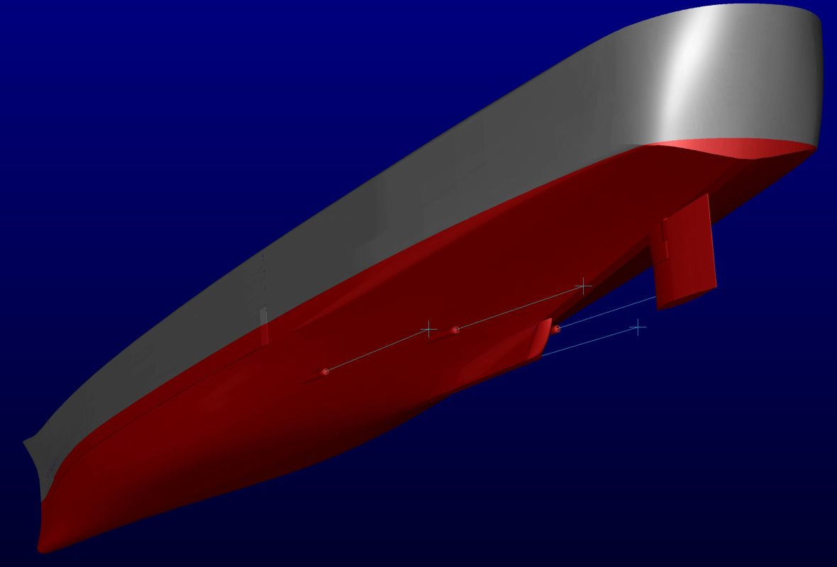

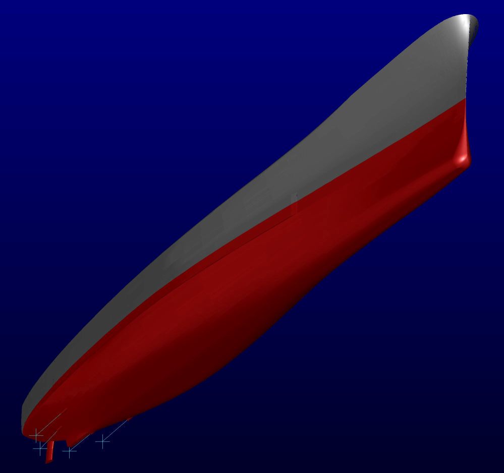

Guess i might as well add myself to the list
Naval Architect/ marine engineer.
Also doing digital hull masters on the side for YMW. As the first one has finally been released, I can post these without letting the cat out of the bag. Unfortunately I've got several more I can't show just yet.
Best Regards
Fritz Koopman
USS Worcester Hull, CL-144 (sorry the exported renderings get funny shadows)
Best Regards
Fritz K.

proflooney wrote:
lol I need to take some surfaceing classes for Solidworks then maybe I can do hulls cause solid lofting sure dont work
Joe
I'm with you, its the way we've always done it. Our old software (which this hull was originally done with, had the fast-surf package). It was a matter of digitizing stations, and then mentally breaking down the hull into its component fair surfaces. I.e. hull below chine, bulb, transom, half-siding, etc. then using diagonals splines to fair the stations and make individual surfaces. Then trim them. Now that we work with solid compatible software, its still both easier and more accurate to work with individual surfaces, and then stitch them to make a solid.
I tried the "deform a solid block till it looks right" method, but I found it near impossible to get it to mach a defined set of existing stations with any accuracy, not to mention issues with chines etc.
Best Regards
Fritz K.

Fritz,
What software do you use?
I work the same way. I could never get a single surface to go through all the contortions at the aft end of the keel without it ending up with wrinkles everywhere. Knuckles weren't a problem in single surfaces, but I usually create two surfaces on either side of the knuckle anyway.
Another place single surfaces were hard to use was at the stern, at the lower outboard end of the transom where the smooth curve of the side meets the knuckle under the stern. You did a good job there on your Worcester hull.
