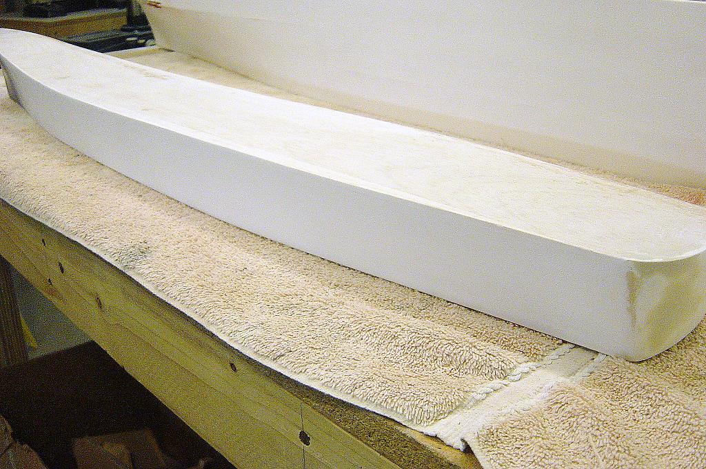

File comment: Close up of the DE hull. Note some body filler work on the stern area. The filler sticks very well to the gelcoating, and blends very well too.

Things are moving along. Much more detail to be added to both hulls before priming and final color schemes. Stay tuned, more to come........I continue on................... :thumbs_up_1: :wave_1:

hi bill,i like the process of using gel coat as a finish coat on your carrier :thumbs_up_1: .one question on it,does it want to run or is it thick enough to stay put when applied.

Hey Russ.....Thanks for the post. This is my first attempt with the gelcoat medium. I laid the hulls on their sides to apply the stuff. Not because of sags or runs, just easier to get at. As far as I can tell, it does not run or sag. Really the best way to apply it is with a spray gun. Gelcoat guns are available, but I wanted to test the material before making the investment on the equipment to spray the stuff. About $200.00 USD for a good gun. The only drawback I can see with this medium is cost. It's about $37.00 a pint USD. I coated both hulls twice, with a little left over with one pint. Sufficient to seal the wood smooth. Smaller projects take less, bigger more, goes without saying. I really like how this works, so I will probably make the investment in due time, although the brush method seems to work well and is alot cheaper. Depends on how far one wants to go. Spraying gelcoat is faster, you reduce the material by 15% with thinner.See pkg. directions. The finish is alot smoother by spraying, although it has a tendancy to "orange peel". With brushing you get brush marks. Just the nature of the material. Sanding is probably easier using the spray method. Thats my observations so far............ :wave_1:

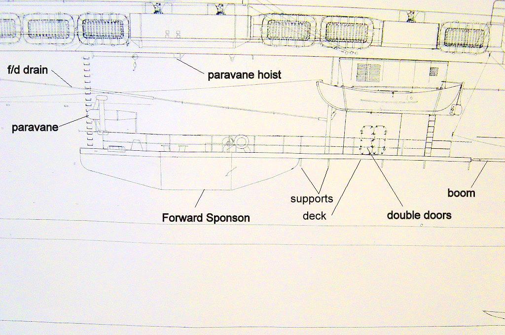

File comment: One of the more challenging aspects here are the sponsons along the side of the hull. This is a top view of the sponsons and the midships platform, stb. side. I'll use these patterns for the styrene decks that are mounted to the sponsons.
File comment: Here's the aft sponson from portside. I've noted some details that I will add.
File comment: The forward sponson layout, again from port side.

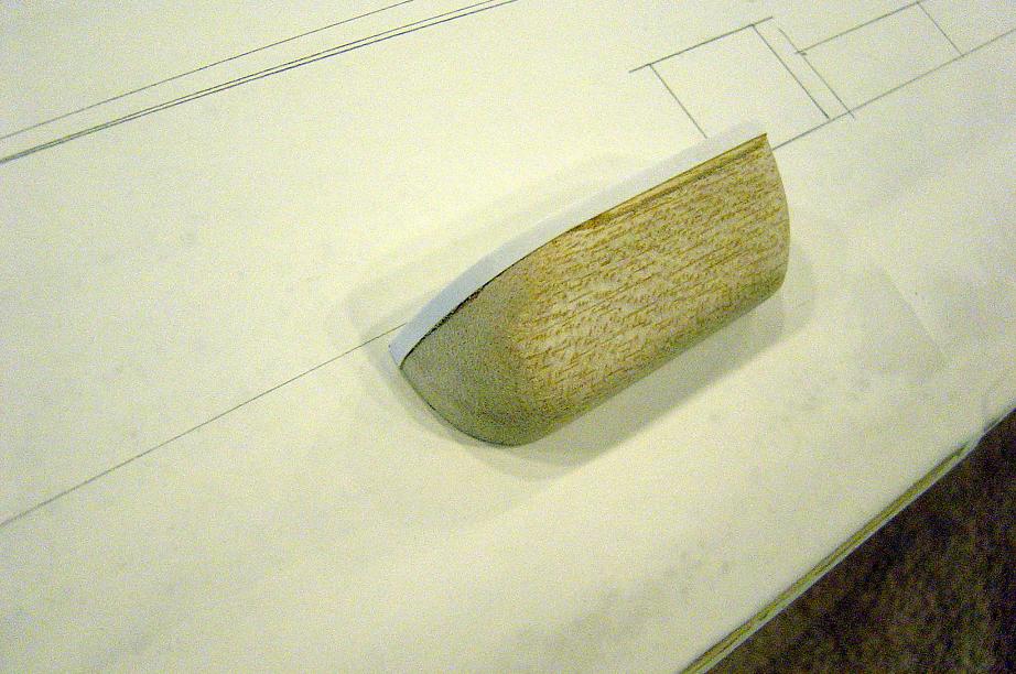

File comment: Sponson now shaped and sanded. I have added a strip of .010 x .125 styrene along the top edge.

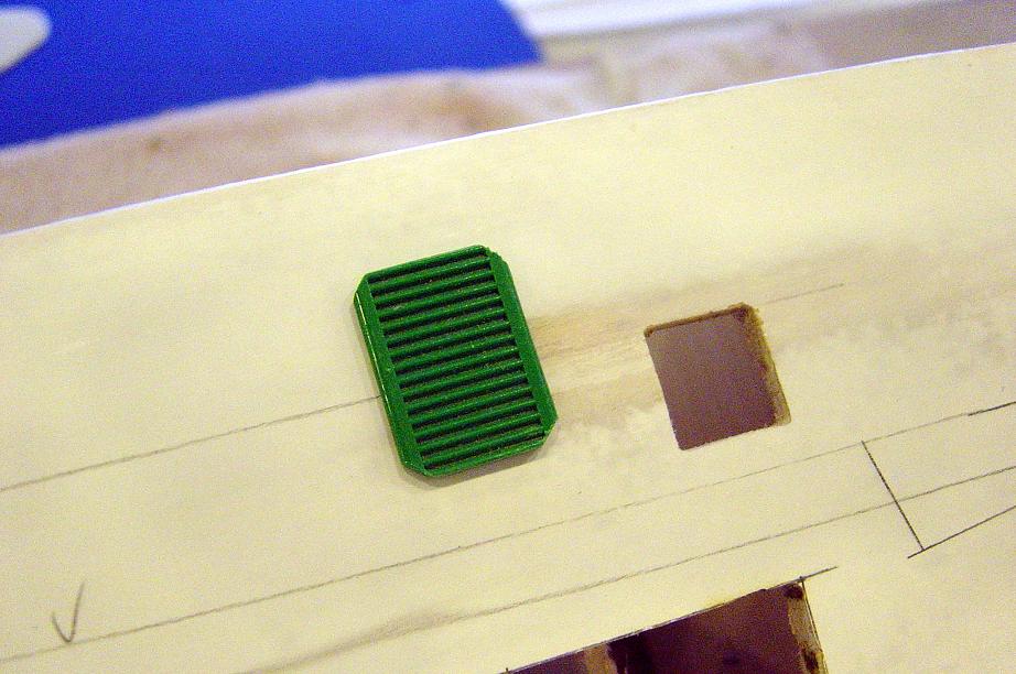

File comment: Here is one of the louver openings. The louver itself is a Lego part, works great here. I'll glue this behind the opening. There are eight of these in total, four on each side.

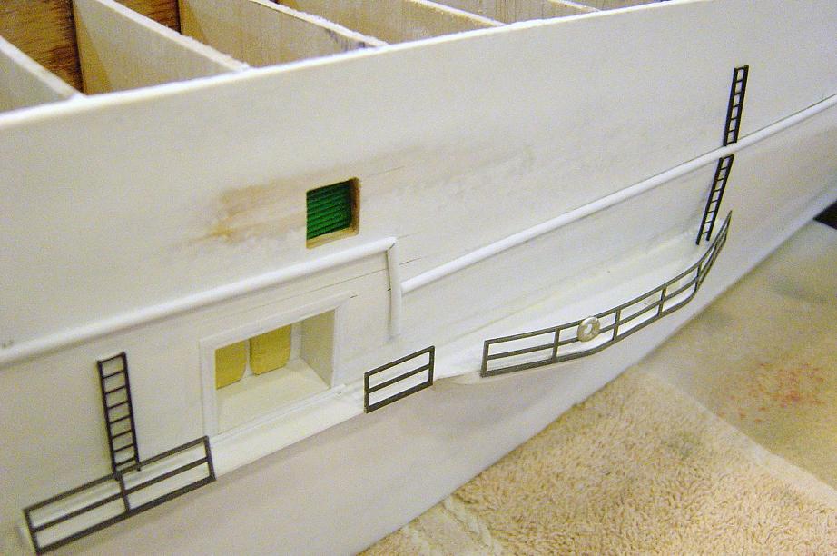

File comment: Doors and louvers now installed.

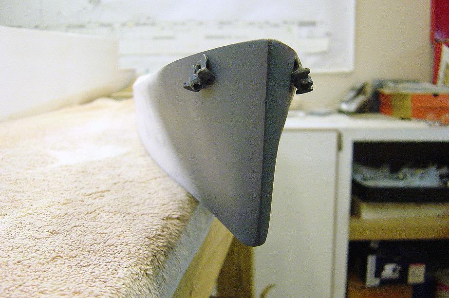

File comment: I'll now add the flightdeck drain pipe. 3/32" styrene tube used here.

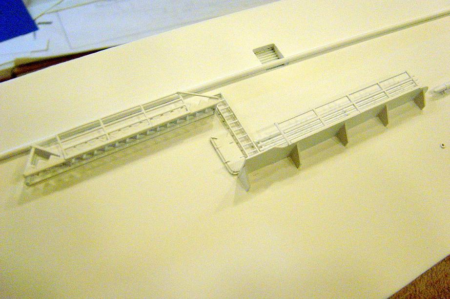

File comment: Next, I'll add the refueling hoses above the aft sponson deck and the midships platform. .040 styrene strip and .047 rod used here.

File comment: Midships platform now installed. I have added an ABS railing.
File comment: Fwd. sponson deck installed and railings added.
File comment: Aft sponson deck installed and railings added.
File comment: Accomodation ladder added, as well as w/t door and ladder. I fabricated the acc. ladder from some spare parts.
File comment: Ladders and a cast metal lifering added to fwd. sponson area.
File comment: Lastly, I have added the 35' boat boom. Tapered wood dowel used here. Pinstripe tape used to simulate the metal rings around the boom and some small steel eyelets added.
