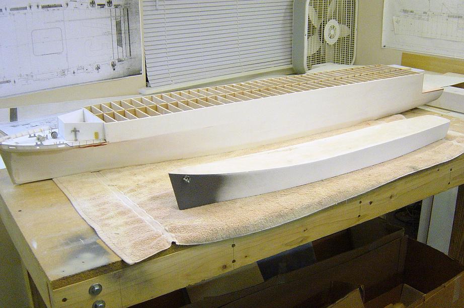

Hello again all. :wave_1: Now that both hulls have been fully sheeted off, it's time to seal the balsa wood. In the past few builds, I have used epoxy marine resin. A bit harder than polyester resin. It worked reasonably well, but it is very hard to sand off. On this project, I am going to a new approach.Read on.......
File comment: As I said, I am going to try a new approach here. These are the materials. As you can see, fibreglass polyester resin on the left. Any brand will do. I'll brush this on as an initial coat for the wood sealing process. On the right is the new stuff. This is marine finish gel coat. It also contains polyester resin. But it also has titanium dioxide and styrene. I mixed this with the hardner and then brushed it on, moving quickly as pot life is only about 15 min. or so. It applies well, sort of like thick paint. The key is the styrene content. You could think of it as liquid styrene. I was pleased with the results, as it sands much like plastic. Alot easier than the epoxy resin.
File comment: Here are the results. Both hulls have now been treated with the polyester resin first, then two coats of the finish gel coat. Sanded smooth between each coat of both materials. I worked one side at a time. The sealing and finish quality of the gelcoat worked great, and it was relativly easy to sand. I used 200 grit auto paper. Note the white color. Although you can't see it well in the photo, both hulls are very smooth and sealed very well.

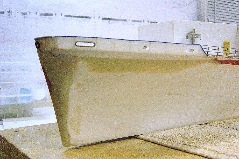

File comment: Close up of the DE hull. Note some body filler work on the stern area. The filler sticks very well to the gelcoating, and blends very well too.

File comment: Here I have formed in the bow area of the DE with autobody filler, and shot a little primer on to check for imperfections, some of which you can see. I'll hit those with a little glazing putty, then sand and prime again.
File comment: Another view here. I applied the filler to the edge of the styrene strip I added earlier, to get that sharp edge line. Anchors are cast metal.

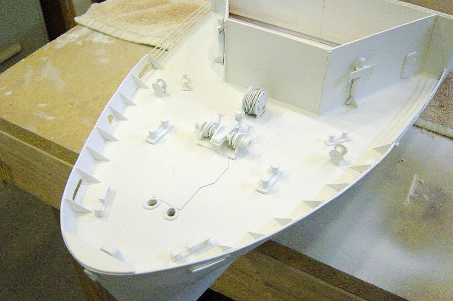

File comment: Forecastle deck details here. A mix of different materials used here. Styrene, cast metal, brass, etc. Again note the bulwark. Bracing is .025 styrene. Once the flightdeck is attached, you won't see much of this.

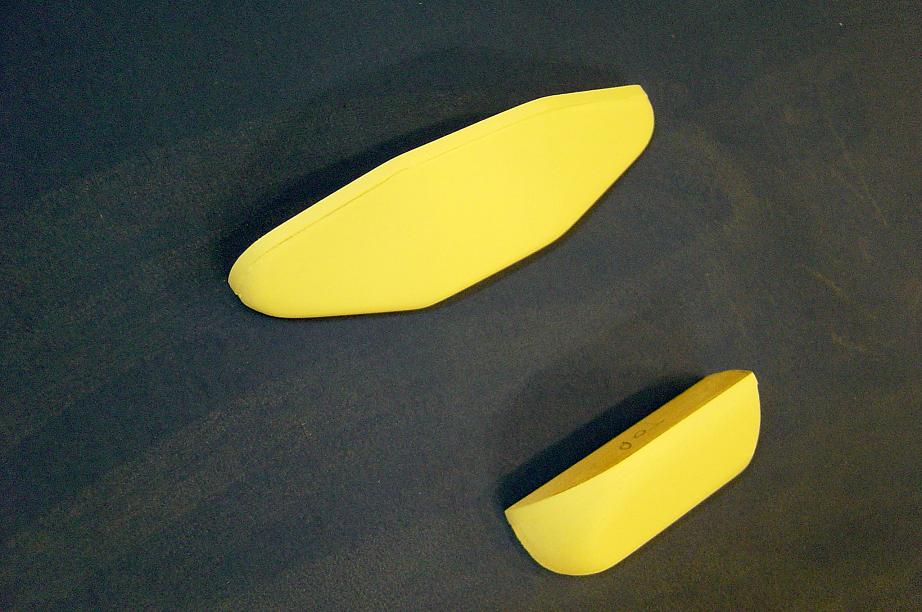

File comment: Next, I have prepared some autobody filler and smoothed it all over the rough shape of this sponson. Before the filler is completly cured, sort of rubbery, I'll shape this out again using 80 grit paper, then follow with 220.
File comment: Sponson now shaped and sanded. I have added a strip of .010 x .125 styrene along the top edge.

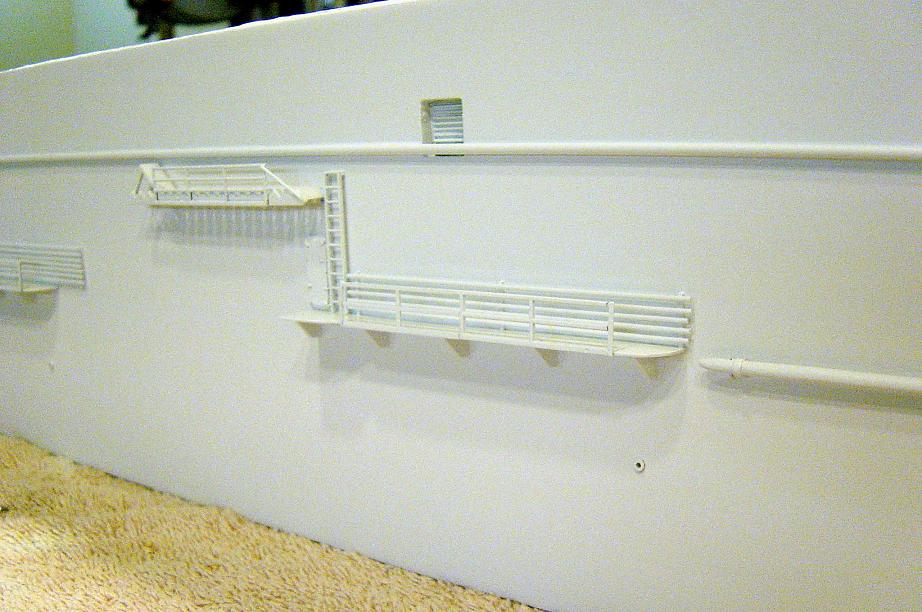

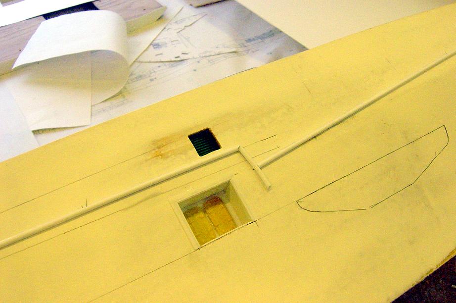

File comment: Along the hull sides, there are several recessed openings. Two are above the fwd. and aft sponsons, and are access ways to the hanger deck via double w/t doors. The others, 4 in all, are louvers which have fans behind them for hanger deck ventilation. I have marked their locations along the hull, and will now cut these out.
File comment: Using a Dremel with a small router bit, I carefully cut out the openings using my lines for a reference.
File comment: The opening for the double w/t doors now cut out and trued up with a file.

File comment: Discharge tubes added along the hull sides.

File comment: Midships platform now installed. I have added an ABS railing.
File comment: Fwd. sponson deck installed and railings added.
File comment: Aft sponson deck installed and railings added.

File comment: Ladders and a cast metal lifering added to fwd. sponson area.
