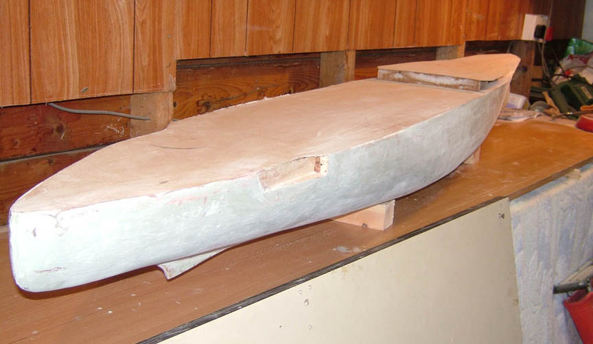

PLANKING THE HULL.
The first thing to do is turn the hull over so she is resting on her deck, also add some weights inside the hull when you first start planking
I use balsa wood 1/8 inch x 3/8 x 39 inches, and use water proof white glue to attach to the hull, were a joint on a rib is , it is cut on a diaganal, this gives a larger area to glue to.
I use house hold pegs to help told the balsa in place, also drawing pins
To get the stern shape I use solid balsa blocks and sand to shape.
Also I do the same at the bow. and then cover it with filla paste.
The hull is covered with very fine fibra matting and resin brushed in to it and left to dry.
The whole hull is then covered with filla paste and sanded to shape, using fine sand paper, and finished off with a wet and dry paper, use lots of water to get a good finish.

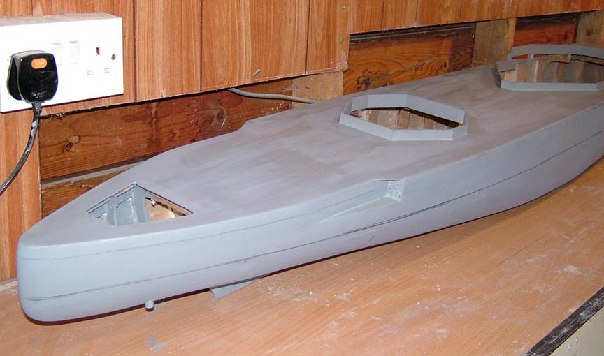

When the hull is dry you can give it a few coats of under coat paint, sanding between each coat.

Now we are going to cut the access in to the deck, as a sailing model we need these to put in our batteries, radio gear and rudders also prop shafts. The hole needs an upstand to stop water getting in to the hull when on the water.

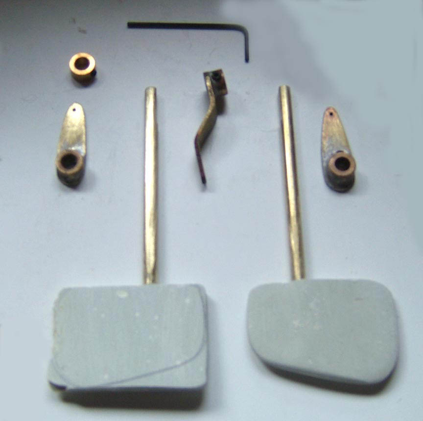

HMS IRON DUKE has 2 rudders, located behind the two inboard props, the first thing to do is put two hollow shafts in the hull in the correct position, behind the two inboard props, sticking out from the hull about 1/2 inch, but inside the hull you have to make sure they are at least 1 inch above the water line, this stops water from getting into the hull when the model is ballasted on the water, if not the water pressure is forced up the shaft and into the model, hence SINKING.
Then we cut two shafts and solder on a piece of brass plate
then make two arms and solder on two lock nuts, also cast a resin filla piece over the brass plates large enough for the rudders,
Mark and sand to shape,
With some wire bent to shape you can make the linkage arms
Then everything is put together in the boat, and you have your rudder control, which is connected to a servo when the radio is fitted, all this work has to be done at this early stage of the build,

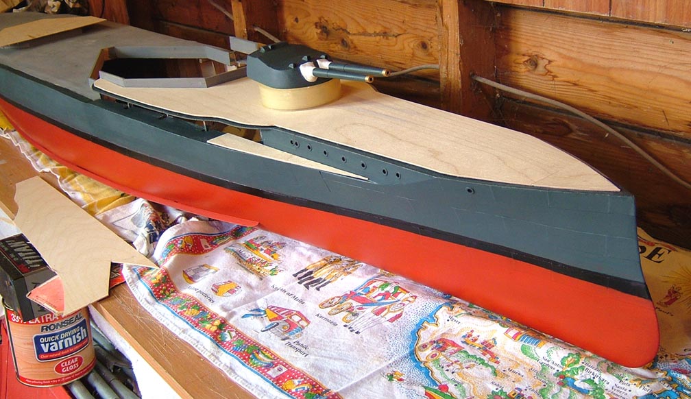

To put on the waterline and anti fouling, I make sure the model is level and mark on a piece of card the waterline.
Then with another card I mark on the anti fouling line.
Then I mask the hull and paint between the two tapes.
Before it begins to dry take off the tape and you should be left with a reasonable black line.
Here's the hull with the sub deck, and one of the turrets just positioned to give some effect
enjoy ARH :wave_1: :wave_1:

Start of Superstructure. First off I purchased 2 sheets of 1/64. ply 4ft x 1ft, this was cut to shape and fitted to both decks, this is the starting place for planking the decks, but it has to be cut and shaped around the access openings.

Deck in position, taped down till glue has set, the balsa will have a covering over it later, either in thin ply or plastic card.

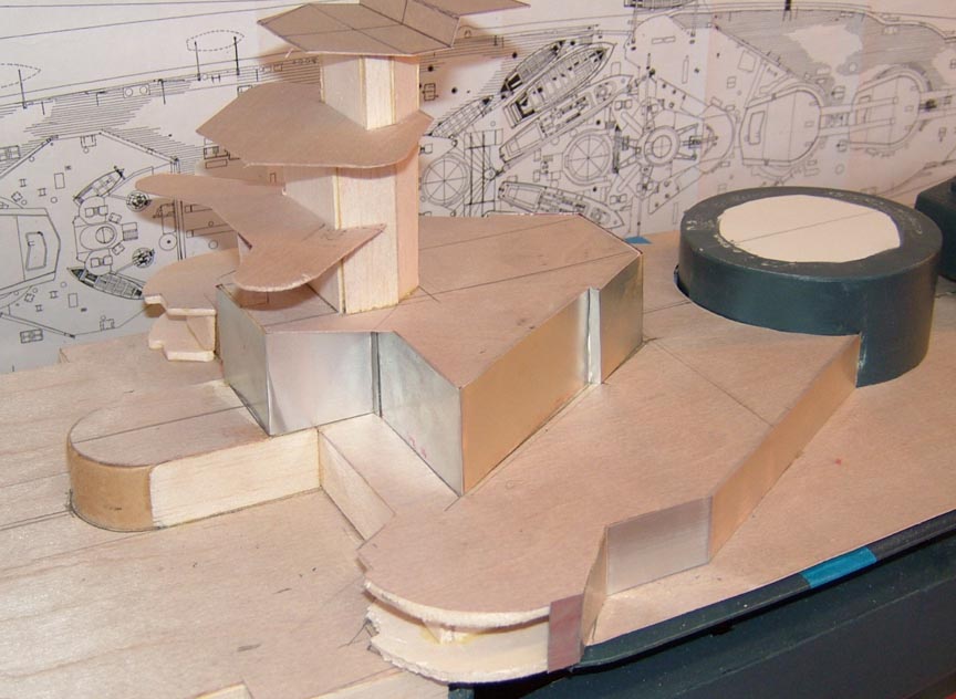

Try in position, at the back you can see the drawings I am working from, they are 1/192 scale, the model is 1/96 scale.
Paint and fit in position, the paint looks a different shade, it will change when it has dried a while

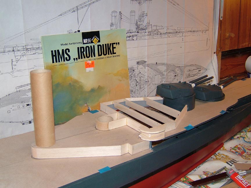

The deck strengtheners glued in position, and the cardboard stack, which will be the base to the funnel.
