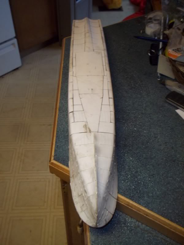

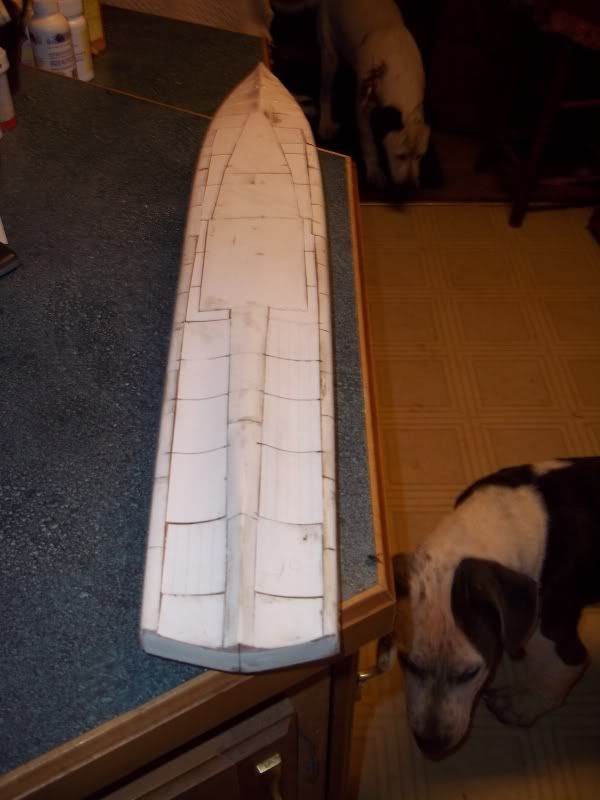

Finished the plating :big_grin:
Then I will glue up the rest of the pannels. :woo_hoo:

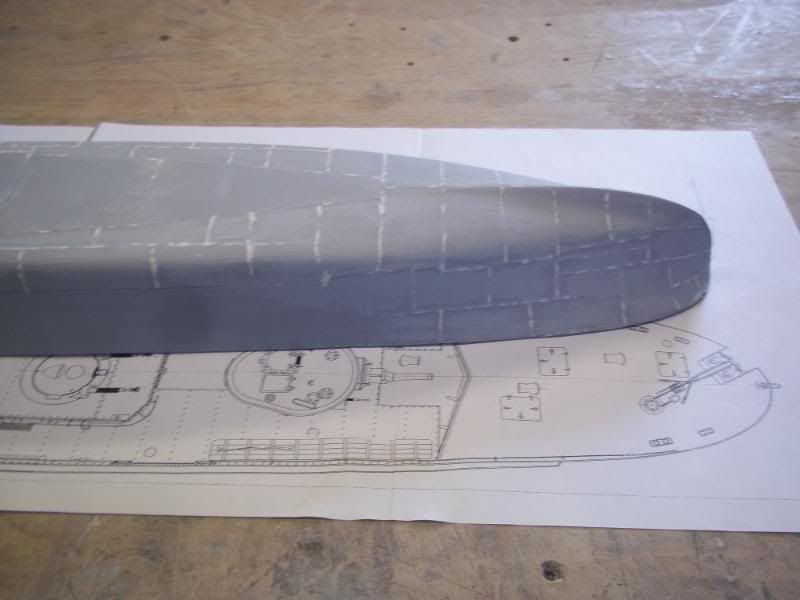

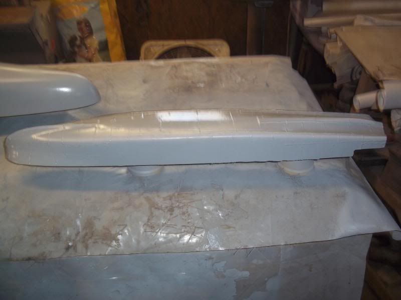

Thanks :smallsmile: I primed it with Poly Auto primer .After she is dry I will sand the welds down .The white glue will show up well with the gray backround . :big_grin:
That is Bismarck's little brother Admiral Hipper also in the photo. :wave_1:

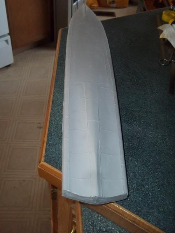

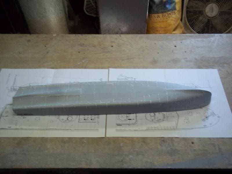

The primer has dried so the next step is to sand it down and reduce the welds .
PostPosted: Mon Mar 21, 2011 6:42 am
Posts: 1012

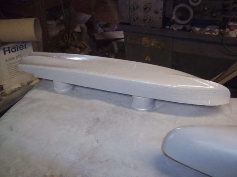

I have rough sanded the hull ..
Now its time to install the armor that was riveted to the sides . :wave_1:

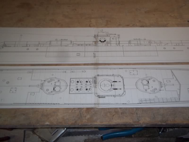

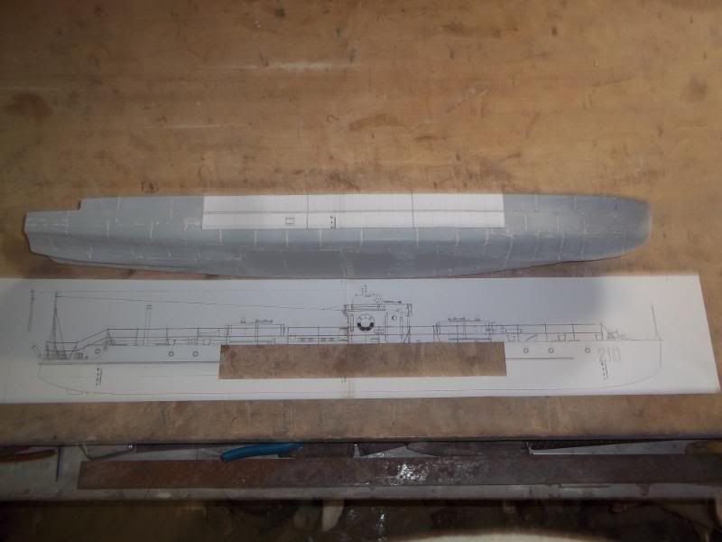

PostPosted: Thu Mar 24, 2011 5:09 am
Posts: 1012
Hi All :wave_1:

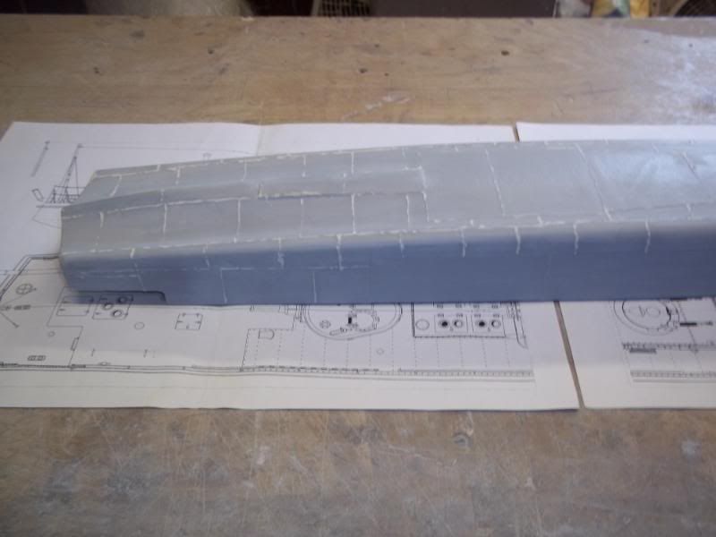

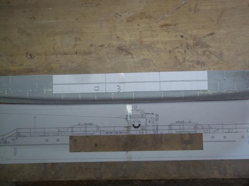

There are three armor plates riveted to each side .The top view shows the armored deck .The deck armor will lift off to get at the RC stuff .I have never built a RC boat so Don at Loyalhanna will help me out in that department .
The plates were cut out of the plans .The middle one and rear one are the same size and have the same rivit pattern .
:big_grin:

PostPosted: Thu Mar 24, 2011 9:17 am
Posts: 1012

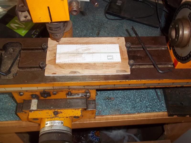

Years ago I made the USS Monitor turret from a steel pipe .I turned it on my lath then put it on the milling machine fixed in a indexing attachment .I then drilled all the rivet holes then drove in piano wire .I then put it back in the lathe and cut down all the wire to just a few thousands above the turret . :big_grin:
That is what I was going to do on the armor plate but it can all be done on the mill .Then I saw Bob's CSS Jackson build were he used styrne rod for rivets so I will try it .
I want to match the rivet pattern exactly as it is so I will use the photo copy as a guide .
I didn't know he had a 1124/1125 kit in the works .They would require two different hulls as they are not alike . :smallsmile:
PostPosted: Thu Mar 24, 2011 10:18 am
Joined: Thu May 10, 2007 9:46 am
Posts: 596
Location: Kyiv, Ukraine
Richard, hi!
May I ask how did you measure the plates length using the plans? To explain myself a little bit - ship hull has certain curvature so that when one measures e.g. plate length using side-view on the plan he does not get into account 'correct length' of a plate which shall be greater for the plate to take (curved) shape of the hull and coincide with its place (marks) on side-view.
In your case the difference may be very insignificant (if any) due to "bronekater" (armour-boat) comparatively straight hull lines at the middle but would increase proportionately to increase of hull curvature (torpedo boats, destroyed, etc or at stem and stern).
Personally I solve this issue using paper models of ships I try to scratchbuild :heh: :heh: - paper models are designed in 3d so that they take into account curvature and provide correct dimensions of plates for example (if they show plates at their models). But someday I have to get to 'raw drawings' and not wishing to do any 3d modeling I wonder how to do it "by hand" so to say.
Yevgeniy
PostPosted: Thu Mar 24, 2011 1:08 pm
Posts: 1012
Hi Yevgenity :wave_1:
Yes you are right any curviture of the hull will distort the plates .It takes a shell expantion plan to see the shape of plates laid out flat .However the 1124 sides were the add on armor goes is flat and straight so I can get away with it on them only .
Good idea using 3-D card models .I will have to remember that one . :thanks:

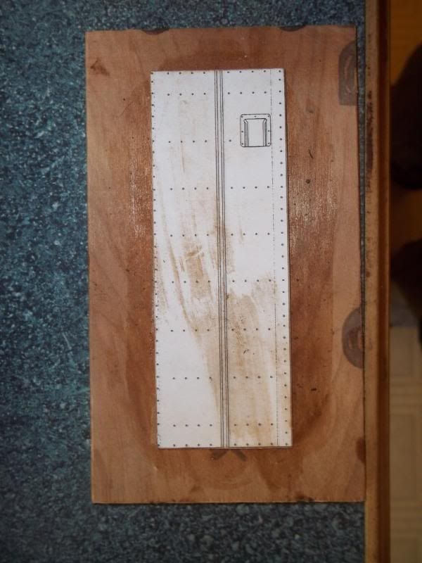

This will be as much fun as watching paint dry but somebody has to do it . :lol_pound: I cut out four pieces of styrene and stuck them together with rubber cement .I then cemented them to a piece of wood so I could use it to fasten down .
Image This is when disaster struck .This little mill has been sitting around for years and the dogs had knocked it over bending the bracket that holds the motor .Any way the belt kept fying off .Good thing I have it's big brother . :thinking:

I am going to do it different now .I don't think the plates are thick enough to hold the rivets so I will have to drill the hull also .What I will do is glue the plates to the hull with a photy copy on each one .Then clamp the hull to the big mill and drill each one going into the hull at the same time . :smallsmile:
