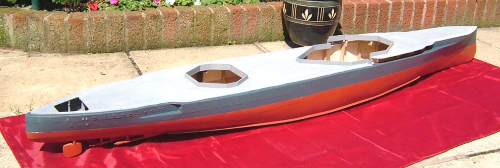

2 shots of the hull with its red primer and hull colour, as of 1916, Battle of Jutland.
enjoy, ARH :woo_hoo: :woo_hoo:

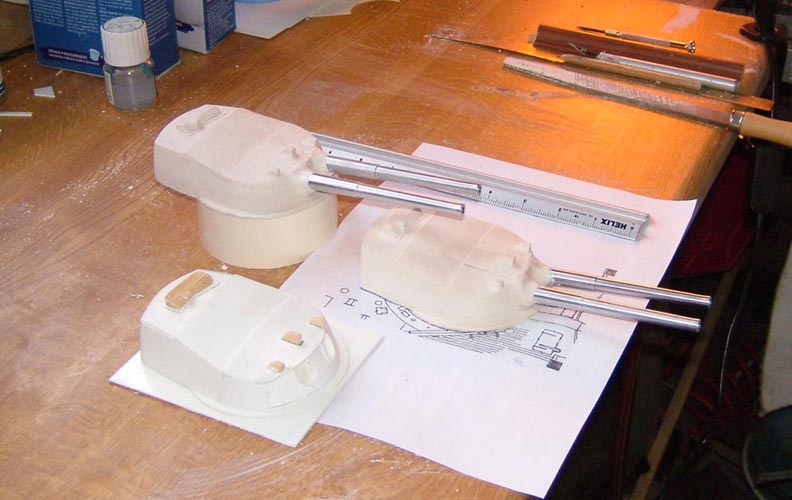

Building the Master for the Turrets.
I decided to build the master out of Evergreen plasticard, having scaled up the drawings on my scanner, I marked and cut the first piece, being the base.
step 2, cut out the back and give it a little support.
step 3 put in a side wall, also give it support.
step 4 do the opposite side. You can see I am using Liquid Poly
step 5 put in brace's and begin to put on the top armour plates
step 6 the near finished object, with outlook sights and riveting, done with a hypo needle and water proof white glue.
enjoy, ARH

Here we have the turrets, and the barrels in place, also the blast bags.
enjoy, ARH

Here's the hull with the sub deck, and one of the turrets just positioned to give some effect
enjoy ARH :wave_1: :wave_1:

Start of Superstructure. First off I purchased 2 sheets of 1/64. ply 4ft x 1ft, this was cut to shape and fitted to both decks, this is the starting place for planking the decks, but it has to be cut and shaped around the access openings.
I also purchased 2 sheets of balsa wood 1mtr x 100mm x 2mm this will form part of the superstructure, I measured the height of the boat deck and cut my timbers and glued them in position around the opening, not forgetting to leave a packing piece in place so there will be room left to be able to remove this deck for access.
I then cut more balsa for struts to strengthen the deck.
Deck in position, taped down till glue has set, the balsa will have a covering over it later, either in thin ply or plastic card.
Bow view
Stern view, with three turrets placed in position for effect.
enjoy, ARH :wave_1: :wave_1:
Simple but effective.

Hi Guys, Its been a busy day, building, painting, photographing, rescaling photo's to fit screen, down loading, typing headings for all the pictures, it seems you have given me a new lease of life in the build.
BARBETTES
To continue the superstructure we need to build the two forward barbettes, the second one is attached to the superstructure so both are marked on the deck for positioning, and holes drilled though to accept the plastic sleeves.
First cut the plastic disk and glue sleeve in position.
Then cut and glue sections of plastic card to the centre section, leaving them just short of the out side of the circle.
Make sure there's plenty of support.
Cut a rim to fit around the out side and glue in place with liquid poly. Weigh it down with some thing heavy and leave to set.
Place in position
Now we start again, only this time it is taller.
This is the piece that will fit round the outside of the barbette, you roll it up gradually in your hands, the heat of your hands helps it bend easily.
Leave to unroll and glue in position
Try in position, at the back you can see the drawings I am working from, they are 1/192 scale, the model is 1/96 scale.
Paint and fit in position, the paint looks a different shade, it will change when it has dried a while
enjoy ARH :wave_1: :wave_1: :wave_1: :thumbs_up_1:
