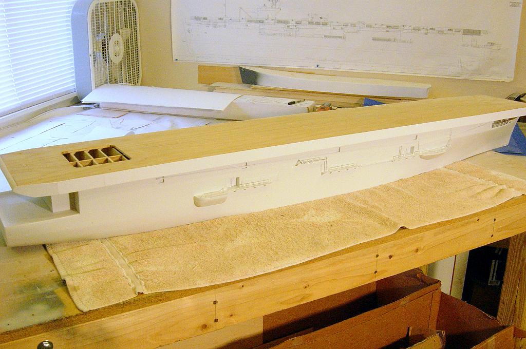

Hello Again all :wave_1: Thought I would post some overall shots of the work done on the sides of the carrier. The DE is now underway and I have begun the superstucture work, using all styrene for construction. Lets take a look.......
File comment: Heres the aft sponson on stb side. A small winch needs to be added here yet.
File comment: Midships and fwd. sponson from stb. side again. Another winch will be added on the fwd. sponson, as well as paravanes and 26' lifeboats, port and stb.
File comment: Overall view from stb. Note I have placed the flightdeck in its approx. position. Aft elevator will be in its down position eventually.
File comment: Good view of portside.
File comment: Midships and aft sponson from port.
File comment: Overall view from portside. Note the DE hull in the backround.
File comment: Superstructure work has now begun on the DE. This is all styrene in various thickness. It appears simple enough, but the up sweep of the hull and deck present some challenges. I am up to bridge level here, with bridge top to be added next.
File comment: Here are the forward 3" .50 cal gun tubs from port. I fabricated the r/s lockers from balsa block and then wrapped with styrene. Note the perforated decking here. Got this in sheets from a craft store, and it is actually used for needlepoint. Works well here as well as areas on the Carrier.
File comment: Here we have the funnel. There are three main pieces here. The base, the main stack, and the cap. All are shaped balsa block wrapped with .010 styrene sheet. Other details are then added.
File comment: Overall view from stb. looking aft. Several more gun tubs to be added yet, as well as numerous small details, but you get the idea.
File comment: Another stb. view looking slightly forward. Note I have marked out locations for other parts, using the plans as a guide.
Well, a short update this time. I will continue with the DE for now before going back to the CVE. Jumping back and forth keeps one real busy. Hope I don't put planes on the DE!!! :scratch: Stay tuned.....more to come,,,I continue on....
