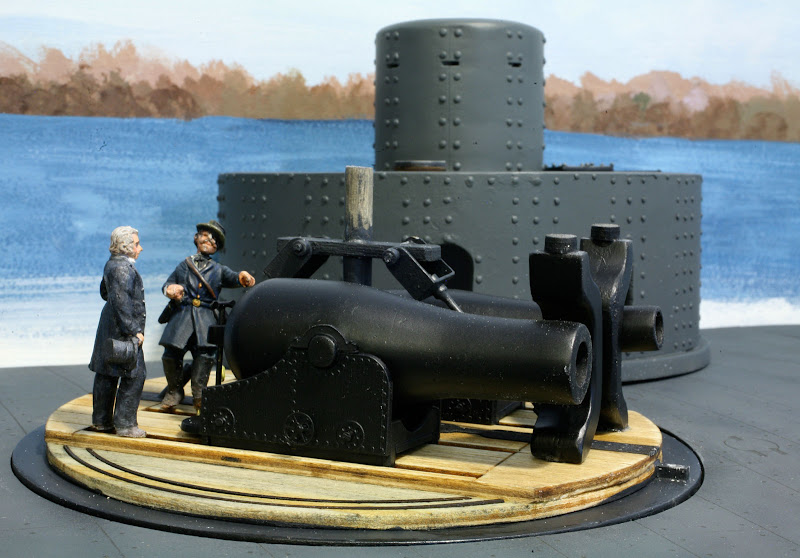

I just about finished the turret for Passaic. I made the turret walls and top removable so one can see the gun.

That is looking fantastic, I saw your post with the turret parts and it's looking good AND it looks authentic.
That laser cutting tool sounds like a pretty cool piece of kit, what's it like to work with?

The laser is a great tool. I find that I use it more and more for model building. But it takes a different approach to scratch building. For example, the Dahlgren gun barrels were laser cut. I cut a series of about 24 at 1/8th inch circular slices with diameters to match the profiles. I glued them to a dowel and sanded them to the final profile. I don't have a lathe, so I used a 1/4 inch chuck power drill to spin the parts for final shaping.tea monster wrote:That is looking fantastic, I saw your post with the turret parts and it's looking good AND it looks authentic.
With my laser I am limited to cutting up to 1/4 inch wood or acrylic stock.
Here is a shot showing the awning installed on the turret. BTW this shot does not show the final location of the ironclad. It will be at the main wharf about 6 or seven feet behind the camera.
There is more info on my blog at http://www.usmrr.blogspot.com/.
