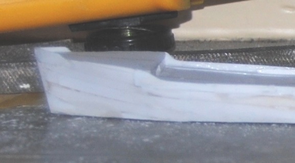

Anyway, on with the building process. Many ships of this period have something which can be described as a diagonal straight stem. Keeping this straight and pointed while carving and plating the hull is difficult as both carving and plating will tend to push you towards a curved stem or too much toward a vertical stem. As you can see in my previous pictures I ended up with a number of loose plates on a rather blunt looking stem which was too short as I had carved off too much balsa. After looking at Jim Russells' Leonard Wood I decided to tackle this by putting a 1*2 mm Evergreen strip in front of the hull and filling the gaps with a combination of balsa scraps and superglue. After sanding this I took my plating (.25 by 3.2 mm evergreen strips) to the new stem strip and started a few rounds of filling and sanding. This is how it looked in early september.

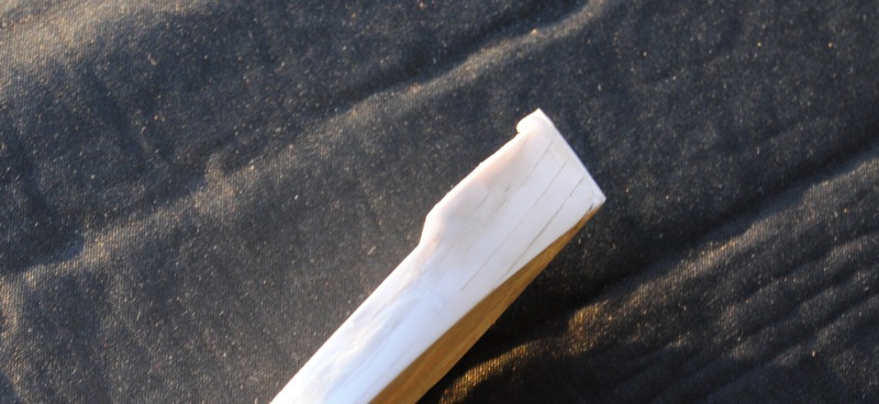

The traditional elliptical stern was much easier to build. Once carved the plating easily followed the hull form towards
the fantail.

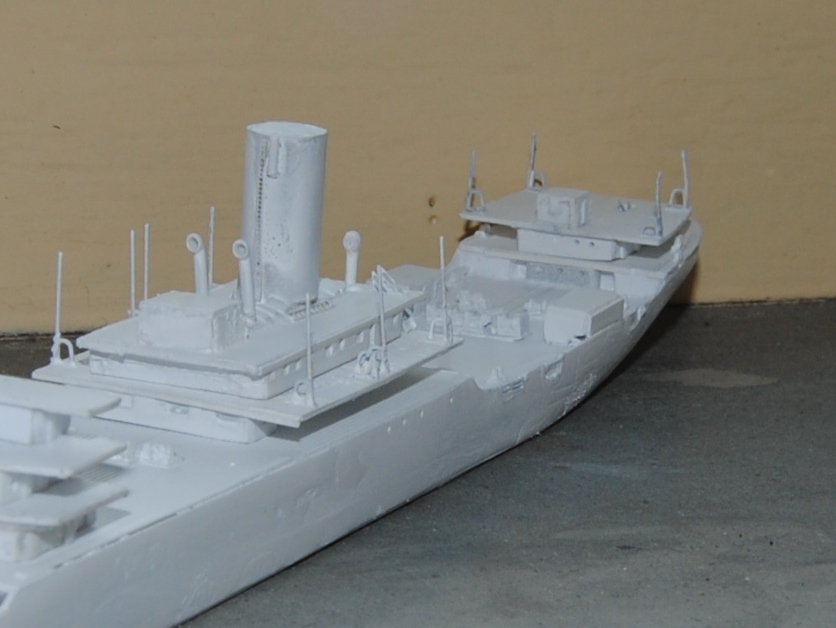

After that I primed the hull and most superstructure parts in Tamiya superfine white. The bridges levels were still unfinished tough and were place temporarily on the hull in order to take pictures .

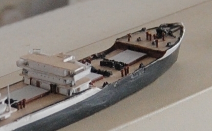

The hull and part of the superstructure have been painted and :

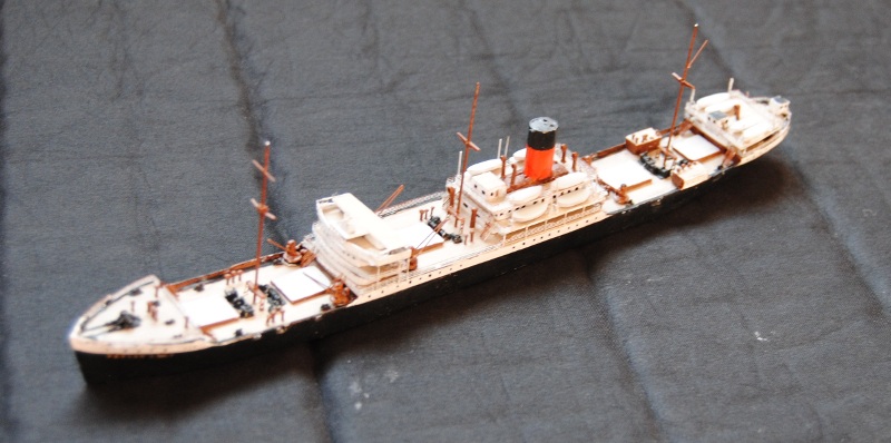

I will be away from my hobby room for the coming two days so I post this to show where the build is now. Will send a timestamped picture to Matt in a few days. I'm also planning to add passengers, rigging and a base later in this thread if that's OK.
Mast and cranes placed yesterday night, finally the classic look I was aiming for:
And how she looks now:

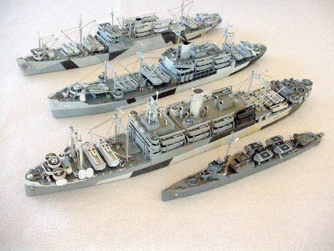

Enjoyed the build! The only addditional photos I took show Leonard Wood with other APA's, the Heywood (another WWI transport conversion), the Burleigh (largest of the WWII built APA's) and an APD for scale. Three more nare planned for the future, a C2, VC2 and a small S4.
