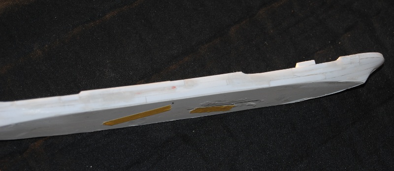

Anyway, on with the building process. Many ships of this period have something which can be described as a diagonal straight stem. Keeping this straight and pointed while carving and plating the hull is difficult as both carving and plating will tend to push you towards a curved stem or too much toward a vertical stem. As you can see in my previous pictures I ended up with a number of loose plates on a rather blunt looking stem which was too short as I had carved off too much balsa. After looking at Jim Russells' Leonard Wood I decided to tackle this by putting a 1*2 mm Evergreen strip in front of the hull and filling the gaps with a combination of balsa scraps and superglue. After sanding this I took my plating (.25 by 3.2 mm evergreen strips) to the new stem strip and started a few rounds of filling and sanding. This is how it looked in early september.
