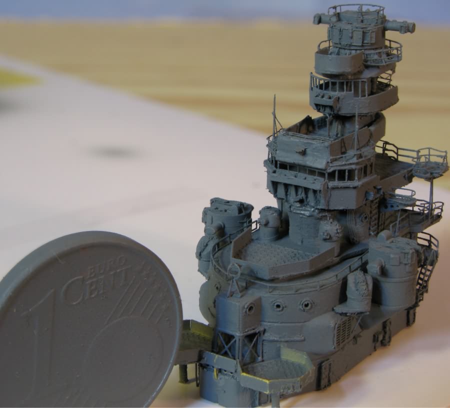

I started with the Aoba (state 1945) from Hasegawa plus the brand new Rainbowmodel upgrade set and PE deck.
But I already added a lot of other parts.
The bridge area is now finished for painting.

Wow there's a lot of work gone on there, and while I find it difficult, its so important to reduce the size of those bridge, deck walls as you have done, so many models with walls that in scale would be 6 foot thick quite often let down a good model, but then again most of mine are untouched and the plastic mould wall isn't the best in the world, although having said that, they are getting better (thinner).
I sometimes snip off a small piece of etch, razor off the plastic wall and apply, or razor off apply rail and cover with a lick of PVA and paint afterward, but sometimes when the wall is removed, there's a slight angle and you'll have to file this flat or its a pain to stand the etch into place.

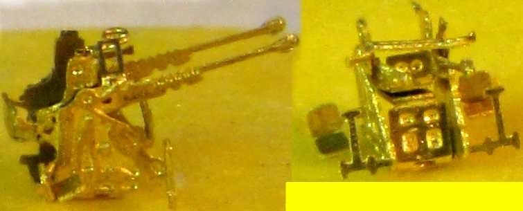

The guns are funny: It is only one PE parts and 17 bendings are required. But after that the twin gun can be finished without any gluing!
Here the part after the 17 bending operations:
