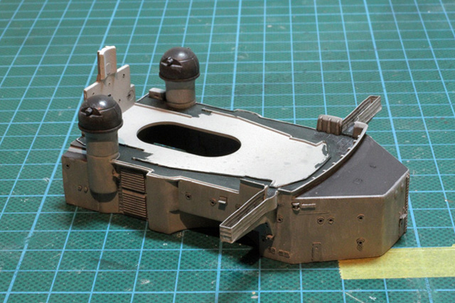

next stage was to paint the various superstructure pieces. The idea was to do a full paint and weathering job and then just drop them into place. Didn't work exactly that way, as the Ka deck complicated the fit. The second deck of the front superstructure actually gave ME fits! :Mad_6:
This was the piece that woudn't fit, even when braced internally.

Another view of the rear superstructure
The PE railings at the top level were later removed, as I could not make them sit properly. I did like the kit-provided foghorn -which had to be drilled- located over the Admirals bridge.
