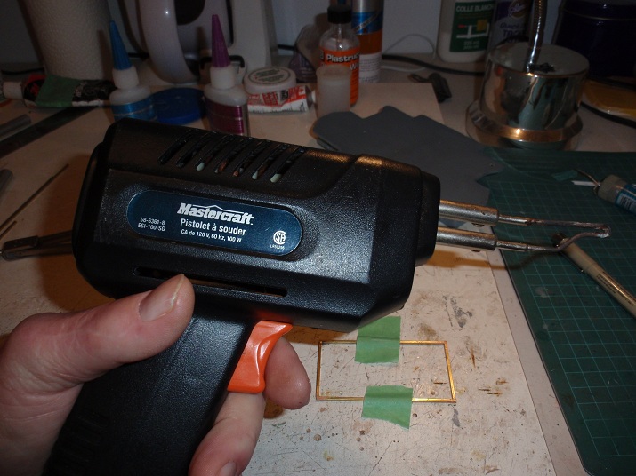

thanks for the intrest guys.Dave i use regular solder and paste flux,i have smaller solder guns but i find myself useing a big trigger type gun more and more.i got tired of waiting for small irons to heat things up .the only thing is it seems to foul up the tip quite often.but i keep a wire wheel on my dremael to shine it up. i would like to try paste solder but so far i have not ran across it over here.to clean up the parts i wash then in lacquer thinner then soapy hot water.

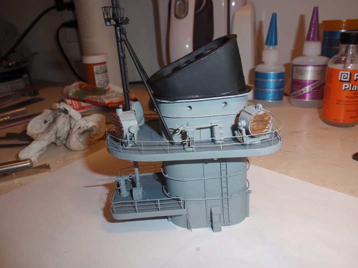

funnel is done i think,one never knows as the more you look at things somthing always shows up :big_grin: .i see in the pics i need a little paint touch up.

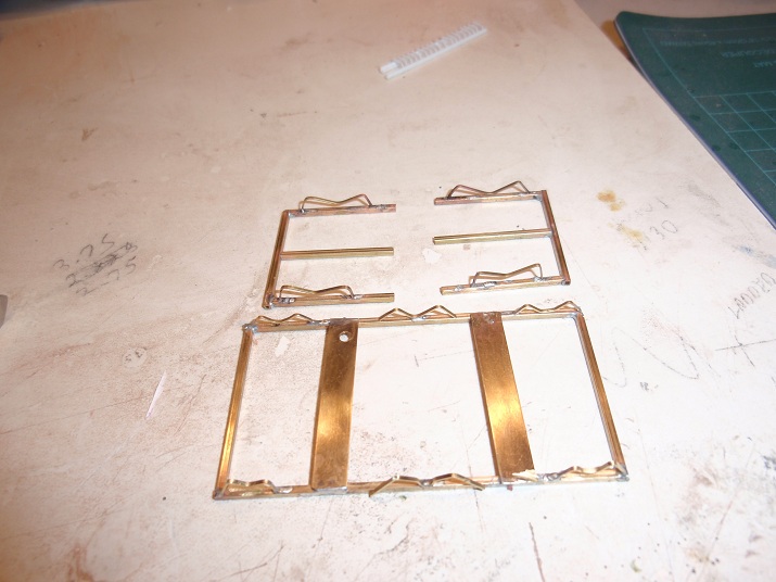

as i was in the soldering mode i built the baot cradles also.
File comment: this is the beast i use for most of my soldering,lots of instant heat.
File comment: cradles by the catapult, and between funnel and front superstructure

Hi Russ Working in brass strip for the boat supports certainly produces excellent results .
