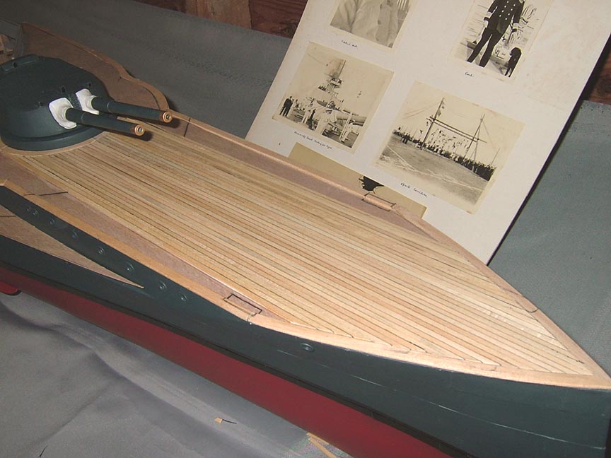

Hi Guys, My timbers arrived this week, so I have made a start on the margin planks at the edge of the deck.
First the flat sections of Eurpean Lime and 150 3mm x 1mm x 1mtre deck planks.
To get the awkward shapes I put the timber under the deck and mark around, cut that side and then scribe out the same shape 3/8 of an inch away and cut, using a good sharp blade #11
The timber is glued in position with compact adhesive, leave to dry slightly before putting in position.
Down by the casement guns it is a little wider, it actually overhangs the hull quite a bit.
A bow shot, beginning to take shape.
A stern shot, note the 12 casement barrels, made by Steve Nuttall.
enjoy, ARH :wave_1: :wave_1: :thumbs_up_1:
ps, have you noticed the clean new grey cover, :lol_3: :lol_3: Victorious is coming tomorrow, took me 3 hours to clean up the workshop.
Simple but effective.

The deck can be lifted off the model, I prefer to be able to do this, as the years go on a sailing model needs a repaint, it's far easier to be able to paint and replace, it helps to keep all your deck lines clean.
That's the whole of one side of the forecastle finished.
The first part of the deck has been lightly sanded, hence the lighter shade, today's work is still darker.
There is a lot of decks to do, but the contrast in colour between the decks and the superstructure should highlight what would be a dull model.
