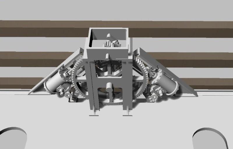

The turret bearing surface was a brass ring. It consisted of 12 brass segments, each covering 30 degrees of arc.
Below is a closer view, showing how the segments were bolted together.
The brass had two broad tiers. The upper tier was the bearing surface. The wall of the turret was laminated from 8 one-inch layers of armor, but only one of these (1-inch thick) protruded down to contact the brass bearing surface.
The lower tier of the brass was presumably used to bolt the ring to the deck. The planking under the ring consisted of 7" x 14" pine. The brass was 4" deep, and is shown here floating 3" above the oak deck beams. I assume the brass ring was mortised into the pine decking so that at its top, it was flush. Two 1/2 inch layers of armor plate overlaid the pine and the edge of the brass. Here is a pencil mode view of the ring. It emphasizes the junctures between the segments.
Finally, here is a view of the framed structure from below.
Notice the two stanchions flanking the crankcase. These two rods also served as the rear "legs" of the galley stove. As noted in an earlier post, the holes in the floor timbers were for ventilation. Note that the floor timbers were 15 inches high forward of the bulkhead, but 12 inches high aft of the bulkhead.
