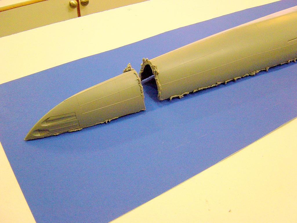

File comment: In order to make this waterline, the first order of the conversion was to cut the hull at the waterline after assembly. I left the decks and side plates off at this point. Shown here is the lower half, cut in three pieces.

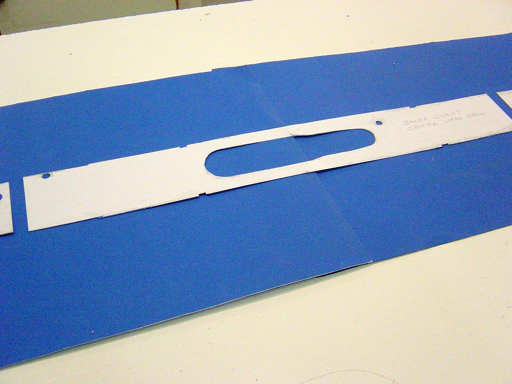

File comment: After cutting the hull, I then took the kit decks and taped paper over the top of them. Then using the side of a pencil, I got the lines for the edges of the new wood deck which would follow the kits molded perforated decks. I then transferred the paper patterns to posterboard and cut them out, making the appropriate changes in locations of deck items, using photos as a guide. This is the fwd. deck section.

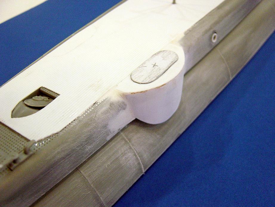

File comment: The new wood deck added forward. I have changed the location here of the accomodation ladder and the fwd. marker bouy well lid. On the Revell kit they are reversed. Note the resin sonar dome, from IBS.
File comment: Here's the aft section. I have added the aft marker bouy well here. Note how it protrudes out from the hull. The one on the Revell kit is on the port side and not near as pronounced. I sanded that one off. This was made from a shaped balsa block then wrapped with .010 styrene sheet. A tricky little part.

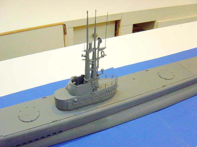

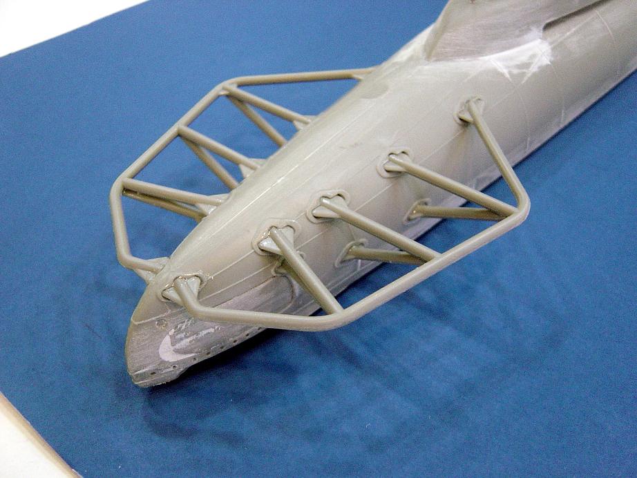

Hello again all :wave_1: Continuing on with the SS-336 build, I have now primed the boat for final paintwork and made a few additions. Lets take a look...........
File comment: Here I have added a couple of "bumpers" behind the forward dive planes. These were to keep the planes from banging against the hull. Parts from IBS in resin.

File comment: A couple more additions to the conning tower. I have added a whip antenna and the UHF cylinder between the periscopes.

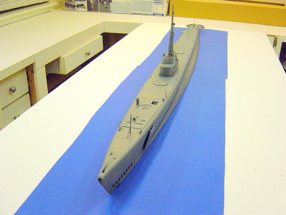

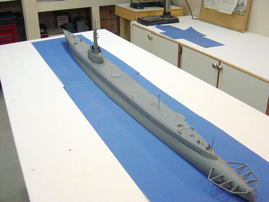

Heres some overall views of the boat.....
With the conversion now completed, I'll move on the final paintwork using Testor's and Tamiya paints, acrylic and enamels. Stay Tuned............More to come.........I continue on :wave_1: :thumbs_up_1:
