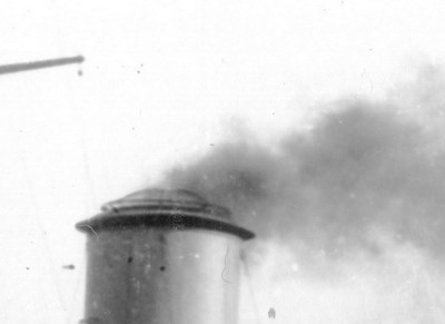

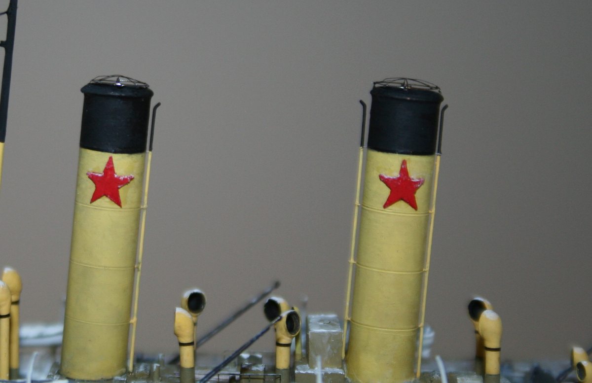

The funnel cages had been bothering me...
the real ship carried tall rounded items--suspended above the funnel on legs
I made mine by creating an athwarships bow in 0.1 mm stainless wire, upon which I then balanced and glued a circle of the same 0.1 mm wire- tacked with varnish.
Once this varnish had set , I backed it up with a droplet of CA appled with a piece of stretched sprue( springy and soft--will not dislodge the delicate assembly )
thereafter I spanned the circle and centre bow with black stretched sprue
( The photos are before painting for clarity )- I was able to tack the centre convergance of the sprue with the aint so that all lay symetrical

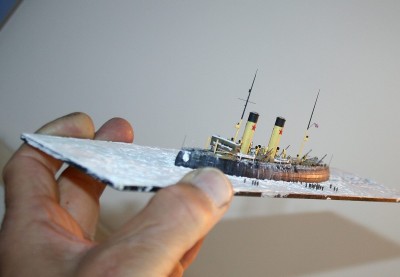

an overview of the ( really rather small! ) completed model just before airbrushing the varnish

That's looking good Jim, but don't forget I did come round your place, I did see that 6 foot hand you have in the garden, so be fair when showing a photo with a hand holding a 3 foot long model lol

Am I allowed to say ''got ya !'' I've been looking and looking and now I must ask, the smokers, why are they so clean ? The tops look new, no sign of soot or blacken surfaces at the top. :thinking:

@ alec.... good point in principle... :wave_1:
however not a single photo of Krassin-
-even the large high res images-- do not show any discernible discolouration of the funnels
The black tops of course are quite broad--and despite being a coalburner contemporay photos show littel or no sooting down the yellow parts either--I can only conclude that the very tall funnels were effctive at smoke dispersal ! :thumbs_up_1:
