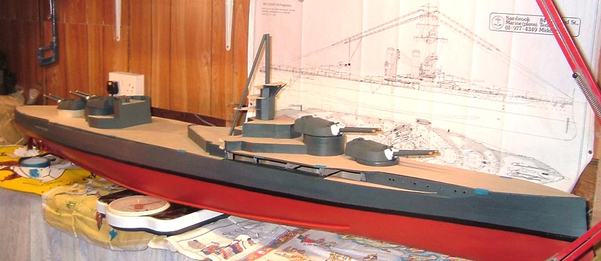

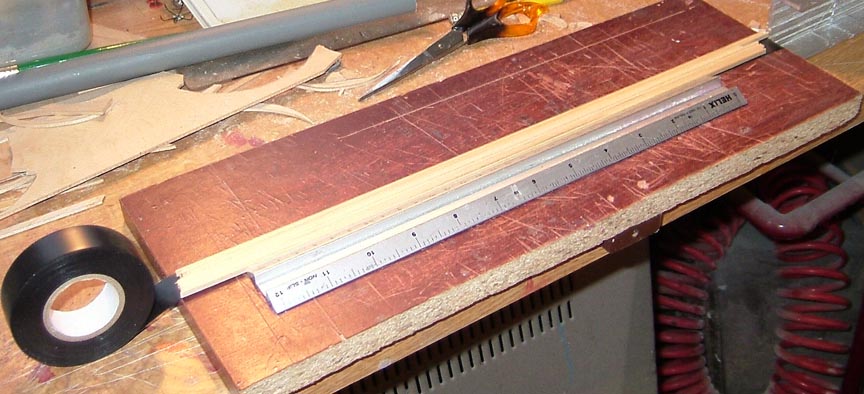

PostPosted: Thu Oct 06, 2005 5:15 pm
Posts: 2557
First of all I have weighed the ship model and it came out at 10lbs, that's with all the turrets on.
As to the camber of the deck, you can see it in this picture, 1/8 inch balsa under the rule either side,
The little housing has been painted and work begun on the middle barbette, this one is slightly taller than the no1 turret and the rear turret barbettes by 4mm.
Work on the 5th barbette at the same stage.
Full view of model, all 5 turret's, second one needs the blast bags moulding and all painting and P/E fitting. :woo_hoo: :woo_hoo:
enjoy, ARH :wave_1: :wave_1: :thumbs_up_1:

For the pitch between the planks we are going to use black electrical tape, sticky on one side. Roll out the tape, sticky side up, turn your planks on edge and press them on to the tape.
Now turn them over and rub your fingers over the tape to make sure it is stuck to the planks

Replaced the barbette and the guns.
A shot from behind the superstructure.
