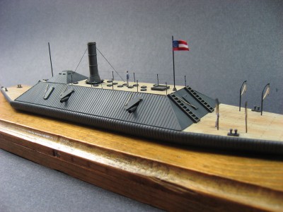

Nice detective work, Charles. I am nearly finished with my CSS Atlanta, just need to add some boats, and I thought she was undersized. What a shame, that's a really nice kit; a bit simplistic in the details, but I had fun building her and she's a good looking ship.
This is a prime example of why I tell everyone to always have at least TWO sources for anything (research, news stories, etc.)

Looks good! We are on the same wave-length I used that color scheme and the gun run outs are the same! I am doing some weathering and then will add the davits and upper railing. I have studied the stack and like you I can only see upper stays, so I will do the same. I added chocks on the bow and the stern area.
The two details I am still mystified by are the rig for the spar torpedo and what they did about the anchor and ground tackle for anchoring. the details for the spar are vague, so I am doing some conjecturing. I don't buy the "s" pattern of the spar I have seen in some drawings - it is impractical. My guess is that the spar angle downward from the focsle. As for the anchor, according to Confederate Iron Afloat, the ship anchored several times suring her aborted sorties, but there are no details on how the anchor was rigged and employed. I also can't figure a location for a hawse pipe, if they had one. My guess is that at a minimum there should be anchor davits which would also help handle the torpedo spar. Perhaps the anchor chain laid on deck, but that does not make sense.

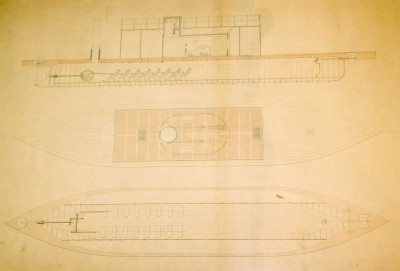

This might not necessarily be ironclad related, but it is Ericsson. I've been doing some research up at Stevens University here in Hoboken. Mainly going through their original files on the Stevens Battery, but yesterday I helped catalog their original USS Monitor drawings. During the sorting process I found the below. sorry for the soft quality of the shots, but we're working pretty low-tech just to document what they have, everything is being sent to the Mariner's Museum in Virginia for proper digitizing.
Thee are definitely not USS Monitor. They're not U.S. at all. I can't remember if Ericsson's signature is on them (several of the original Monitor pencil drawings in the collection are signed by him) but the title and all of the annotations are in Swedish. It's a period color drawing in black, blue, and red. Note the rowing crew members for power, and the non-rotating gun tower for the single cannon.
Does anyone have any idea of what this is a drawing of? Was it actually built, or one of his prototype ideas? And also, a time frame? I could see it being pre-Monitor due to the human and fixed turret, but things like the rudder assembly make me think it's contemporary to or post Monitor.
There's also another one of these drawings that looks to be a modified Passaic class hull, same Swedish titles and annotations.
File comment: Overall view
