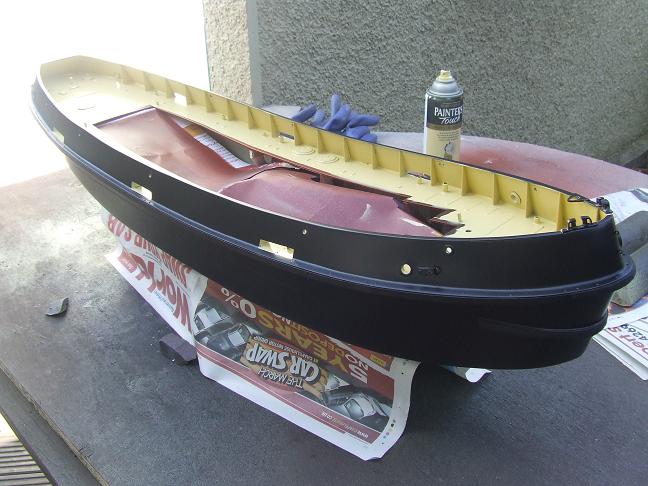

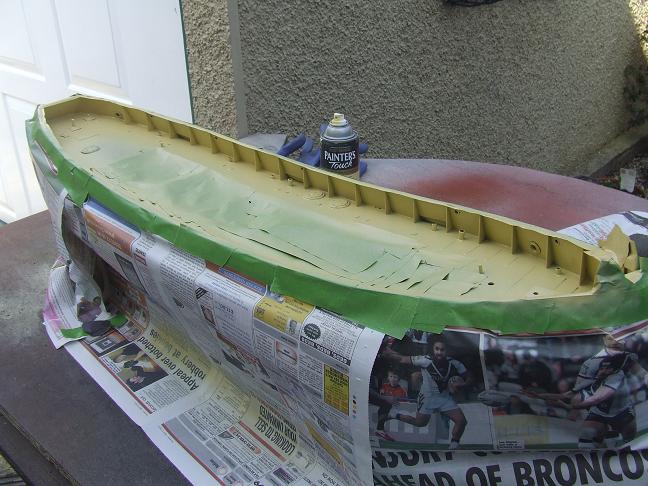

Time to paint the inside of the bulwarks so I masked off the top rail with low tack masking tape and the used newspaper to cover the rest of the outside of the hull. The paint was applied in thin coats allowing each to dry before applying the next to build up the depth of paint without any runs. Once dry the newspaper and masking tape was removed.
Tiny

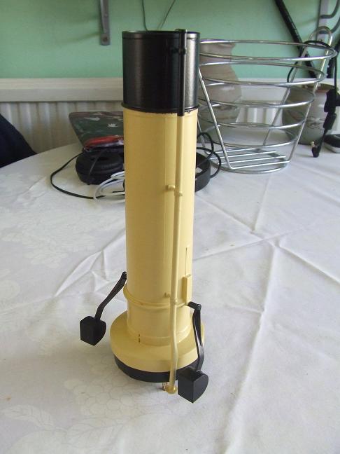

Funnel
The first stage was to spray under coat the funnel with red oxide paint and allow it to throughly dry. Next using Archers Finescale surface decals I applied the decals to simulate the welds on the funnel and left them to dry for a few days. A final coat of red oxide to seal the transfers before I applied the first coats of Navy yellow. Again I left this to dry for a few days to ensure the paint wouldn't lift when applying the masking tape for the top section of the funnel. Finally the top section was sprayed black and the counter balance weights added.
Regards
Tiny

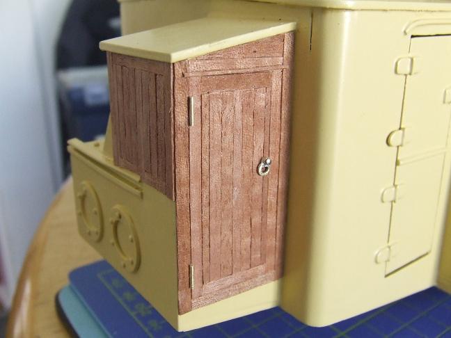

Planking the toilet block
Now that the final coat of paint as been applied it was now time to plank the toliet block starting with the outside frames. Using 3mm wide 0.7mm thick mahogany strips each piece is measured, cut and glued in place with superglue. Once the outside frames were complete I continued with each infill panel and door finishing off with the brass hinges and door latch.
Tiny
