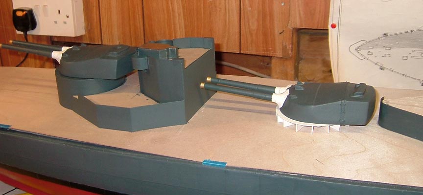

As its Saturday the class can have a short lesson, :lol_3: :lol_3: :woo_hoo: :woo_hoo:
We will continue with the rear structure, I cut more balsa wood to finish the second level structure, inside we put our usual strengthening pieces to take the floor, where the balsa wood is I have used balsa cement and pins to give it added strength.
The back was cut to shape out of the litho and glued in place.
Next the side, note the cut down next to the barbette, this is were a ladder fits either side.
We go to the upper structure and fit one side, again a cut out.
The cut out is for a 24 inch search light,
enjoy, ARH :wave_1: :thumbs_up_1:

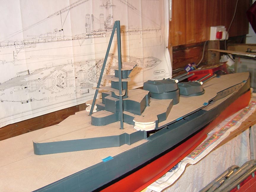

Quiet at the back, :Oops_1: :sorry: After that short recess we will continue with the build,
I finished off the opposite side of the rear turret housing, there is still more litho to do when I have worked out the small structure that fits on top, the edge of the barbette was sanded to shape.
The first part of the forward superstructure gets a coat of WEM colour matched paint
BOW shot
STERN shot
Close up shot, tripod mast painted.
Rear superstructure painted.
A long shot of the ship, from the stern, 4th turret painted.
A long shot from the bow showing the nice lines of the hull, also the difference between the superstructure colour and the deck colour when planked.
Second coat of paint on structure.
enjoy, ARH :wave_1: :wave_1: :thumbs_up_1:

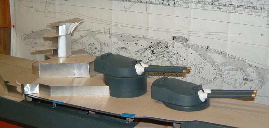

Hi Guys, Not a lot tonight, but a little complicated,
We first shape a block of balsa wood, put a thin skin of 1/64th ply around it and on top, it helps to take the litho better, we have also put in the front of the superstructure.
Rear view.
I have covered it all over with the litho plate.
A view of the whole structure, with turrets.
A close up, I have drawn in where the set of p/e ladders will fit.

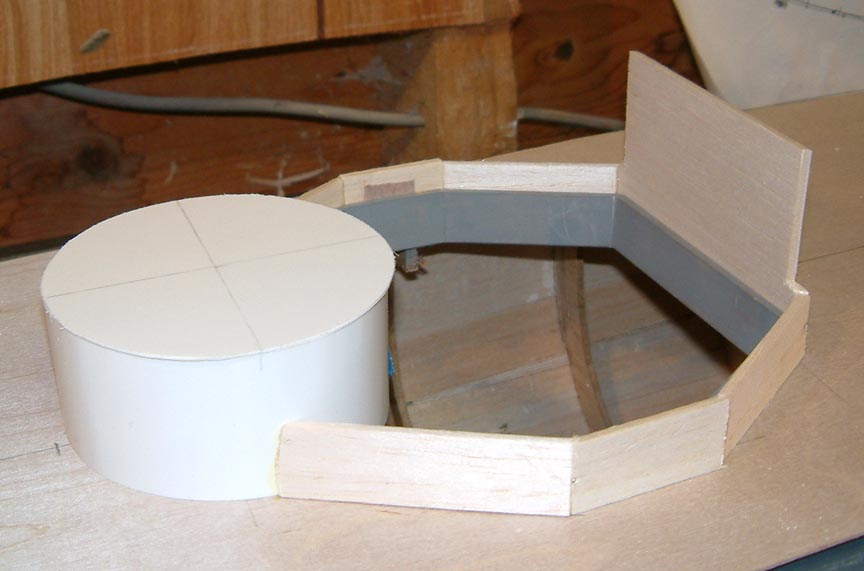

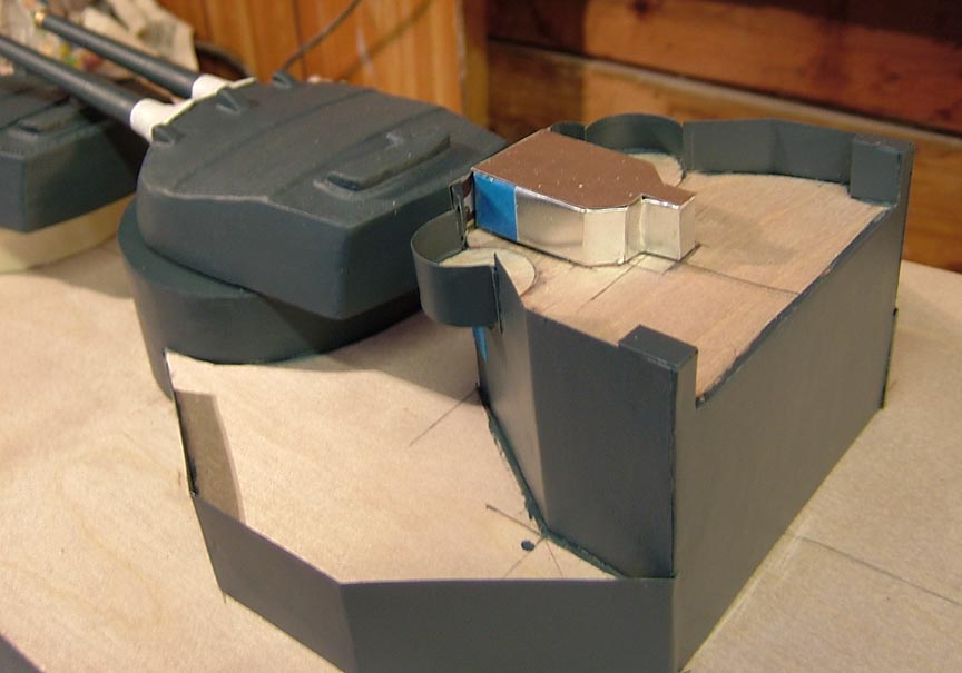

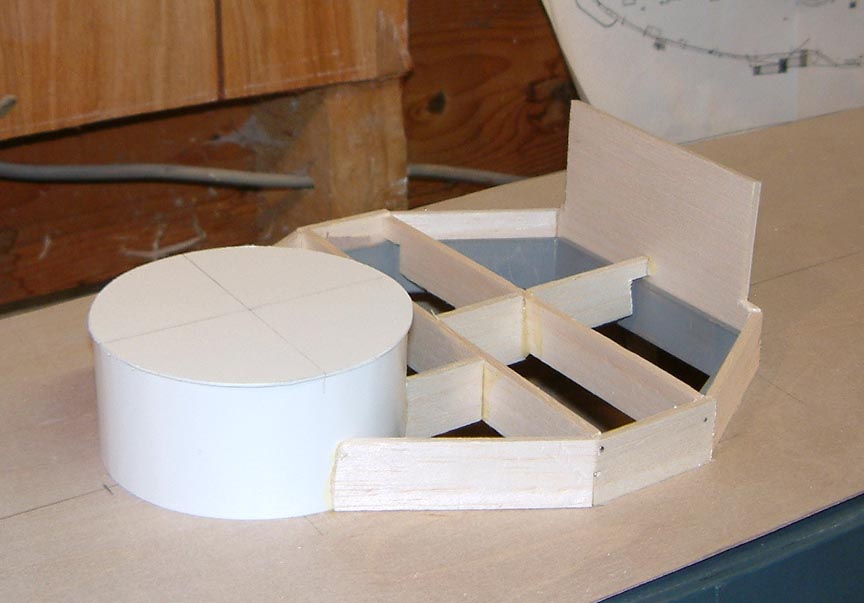

First of all I have weighed the ship model and it came out at 10lbs, that's with all the turrets on.
As to the camber of the deck, you can see it in this picture, 1/8 inch balsa under the rule either side,
The little housing has been painted and work begun on the middle barbette, this one is slightly taller than the no1 turret and the rear turret barbettes by 4mm.
Work on the 5th barbette at the same stage.

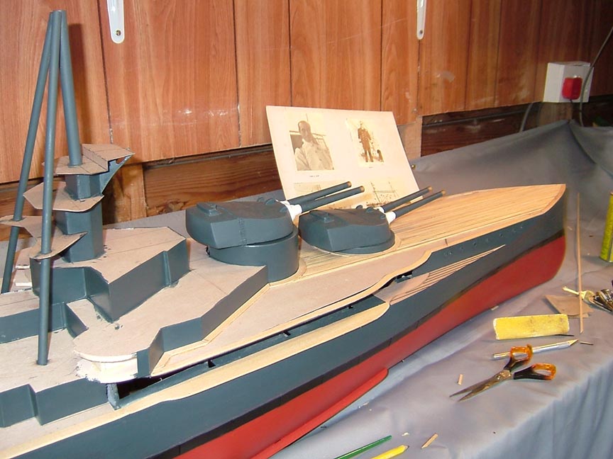

Hi Guys, My timbers arrived this week, so I have made a start on the margin planks at the edge of the deck.
First the flat sections of Eurpean Lime and 150 3mm x 1mm x 1mtre deck planks.
To get the awkward shapes I put the timber under the deck and mark around, cut that side and then scribe out the same shape 3/8 of an inch away and cut, using a good sharp blade #11
The timber is glued in position with compact adhesive, leave to dry slightly before putting in position.
Down by the casement guns it is a little wider, it actually overhangs the hull quite a bit.
A bow shot, beginning to take shape.
A stern shot, note the 12 casement barrels, made by Steve Nuttall.

Hi Guys, Tonight we continue to plank the deck. As you can see I use a little weight to hold the edges down till the glue dries.
14 more planks laid on the opposite side, these 14 planks took 35 minutes to cut, put on the tape, mark out and lay.
We have now run 1 long piece though and are working back to the centre line.
Replaced the barbette and the guns.
A shot from behind the superstructure.
The deck can be lifted off the model, I prefer to be able to do this, as the years go on a sailing model needs a repaint, it's far easier to be able to paint and replace, it helps to keep all your deck lines clean.
That's the whole of one side of the forecastle finished.
The first part of the deck has been lightly sanded, hence the lighter shade, today's work is still darker.
There is a lot of decks to do, but the contrast in colour between the decks and the superstructure should highlight what would be a dull model.
