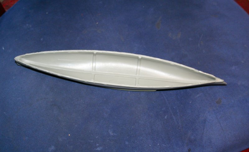

Kombrigs 1/350 resin kit range features very light, stable hollow hulls, upper and lower
the skin thickness of the hulls are akin to injection moulded hulls.
I have no photo of a kit on my PC-but can take pics tomorrow if anyone is interested ...

Here a a few quick snaps of my Kombrig 1/350 resin kit of the IJN Nisshin
The upper and lower hulls are cast separately--and both parts are hollow.
