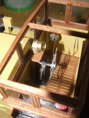

I have been concentrating on painting various fittings in the wheelhouse and the black areas on the superstructure. Also I have been wiring the LED lights in the mast and routing the wires inside the superstructure.
