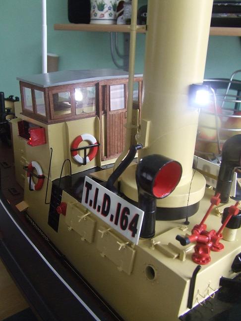

I have been concentrating on painting various fittings in the wheelhouse and the black areas on the superstructure. Also I have been wiring the LED lights in the mast and routing the wires inside the superstructure.

Lighting
With all the LED lights fitted and the wires routed around the inside of the superstructure all that was left to do was to solder each one to the 6v battery/resistor module I had made. Using a 15W soldering iron each wire was soldered in place ensuring the correct polarity was maintained. Finally all the soldered joints where covered with two part epoxy glue to ensure that the joints would not be effected by any moisture.
