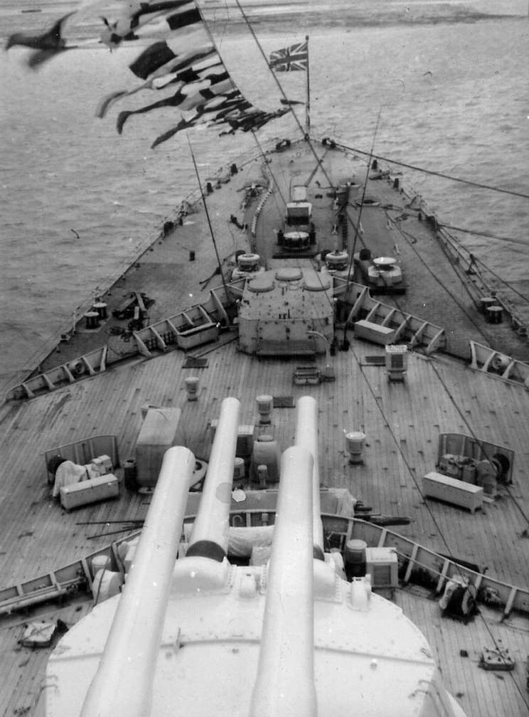

Hello,
I started with the building of the Samek HMS Vanguard kit.It is a real good kit !! I have got it direct from Czechia for a good price :woo_hoo:
But after i have compare the kit with several pictures of the real ship and some kits from the MW gallery i wondered about the wood planking at the area of the forcastle.
On pictures of the real ship and on most of the kits it seems to be a steel deck and not a wood deck up to the first breakwater. At least it's different and darker colored.
Who knows more about this ?

Hello Chris, You are right. The bow down to the breakwater should be metal and painted in dark grey. Alot of resin companies make this mistake of planking all the way up to the nose.

Just to agree with Sirpaul, the Science Museum of London model of HMS Vanguard has the forcastle without planking... http://battleshiphmsvanguard.homestead. ... Model.html

Hi, thank you both for your comments. :wave_1:
I have found also this website ( http://www.hms-vanguard.co.uk/) and the pictures of the museum kit ( http://battleshiphmsvanguard.homestead. ... Model.html) before and it was one reason why i asked this here. :big_grin:
I was surprised that on a German website ( modellmarine.de) and at MW reviews, the Samek model was introduced and there was referring to the wooden planks on the foredeck would be correct.
http://www.modellmarine.de/index.php?op ... m&Itemid=1
http://www.modelwarships.com/reviews/sh ... review.htm
But i have the same opinion like you that this must be a mistake from Samek. On all pictures i have seen, the appearance of the deck before and after the first breakwater is different.

The wooden planking on the foredeck is incorrect.
In many photos you can see the steel deck to the first breakwater. Good to see the book "The British battleships of World War II" by Raven / Roberts.

I am not sure that the "planking" on the foredeck of the Samek model is supposed to depict wood. The ship had a pattern in the plating of that area that was visible. Note that on the model, aft of the breakwater the scribed lines are fore-and-aft. Forward of the breakwater, they are angled. Those angles match the angles of the plating pattern. So, just paint the forward area dark gray rather than tan.

Yeah but they are in square plates.

Not fully correct: the pattern consists of welded on ribs (to provide some traction) these ribs are about one foot long and each one perpendicular to its neighbours. I'll try to make a scan of a plan drawing I have that shows them.
Anyway, on 1/700 scale these ribs are too small to reproduce credibly.
