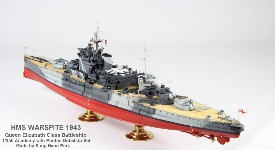

Hi, all
It took me 8 months to finish this Warspite.
I'm so busy doing PE design that I don't have time to make ship model as a hobby.
Thank you
SH Park
Pontos model

Posts: 10621
Location: EG48
Re: Pontosmodel 1/350 Warspite Full set
Post by Tracy White »
Nicely Built!
Dave Spencer
Posts: 121
Joined: Mon Jun 25, 2012 7:28 pm
Location: North Wales
Post by Dave Spencer »
That is alovely clean build, Mr Park. It also helps me with the placement of one or two items, too (ie night bouy).
I notice you have used the camouflage pattern on the bridge structure as per the Prussia Cove pictures. Me too. :cool_2:
