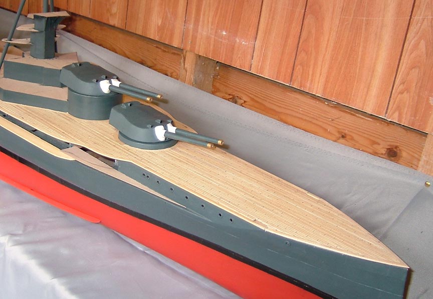

You can see the camber on the bow

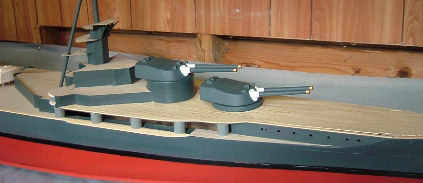

I have cut the casement gun protections and placed them in position, these were cut from plastic water piping.

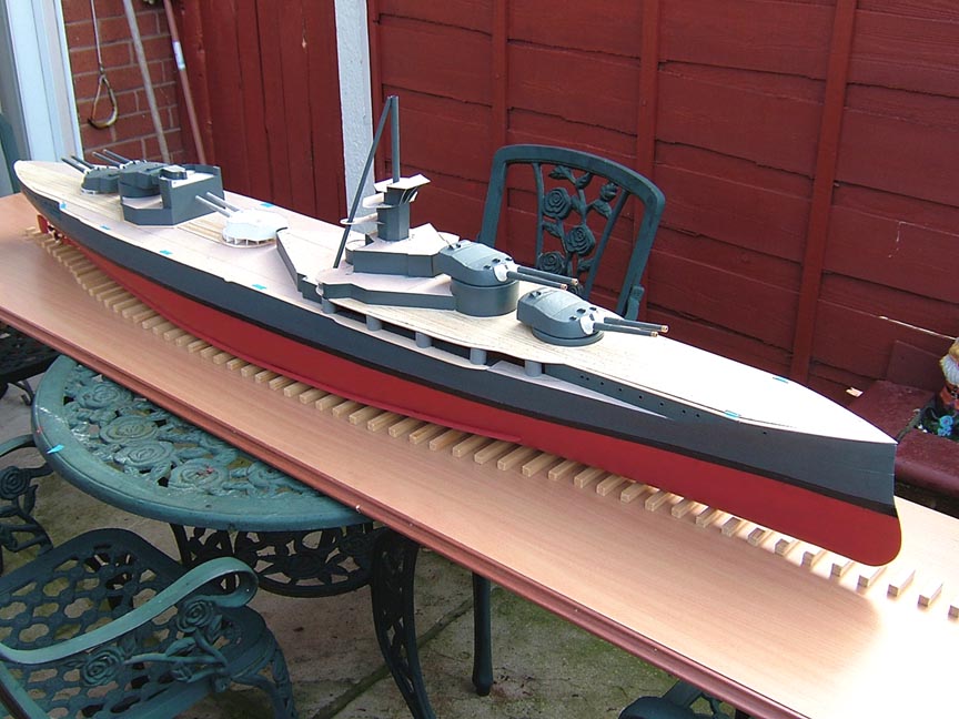

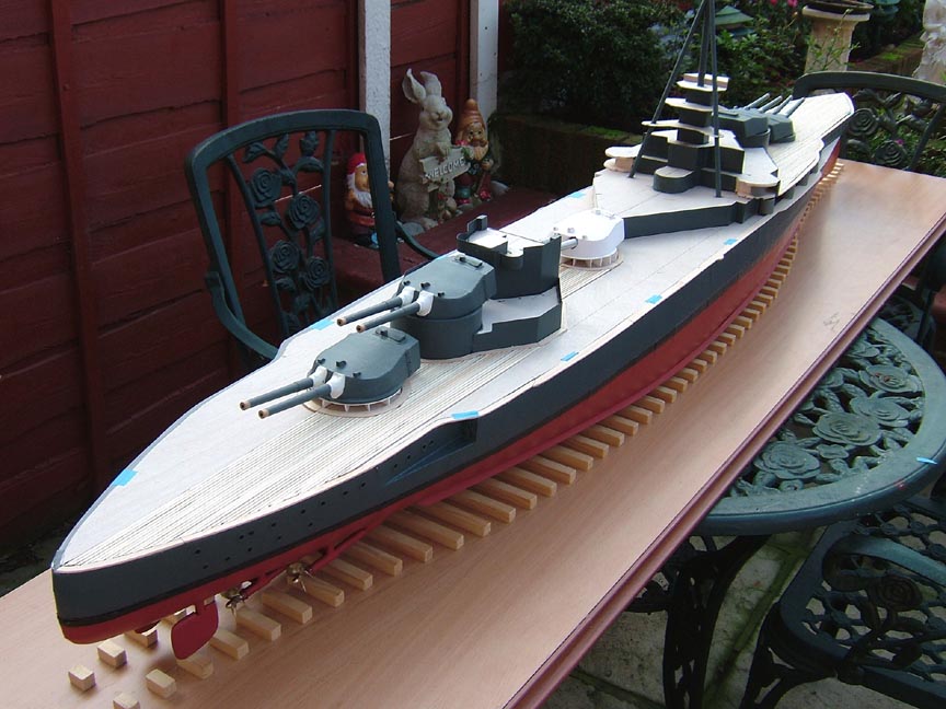

The ship yard was open today, some gnomes turned up, I think Jim B must have sent some of his.
We are still doing the the planking.

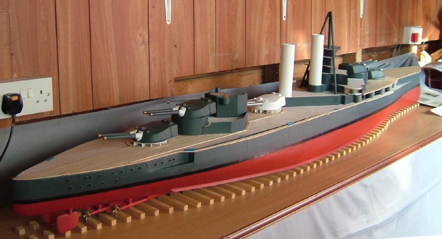

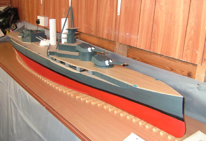

We have borrowed the NC dry dock and took some photo's outside, a little to sunny. The photos are all 12 inch to try to keep the text on the page and the down load time quicker, so it effects the quality, I hope you don't mind.
Notice the difference in length, 150ft scale wise but 30 years on.

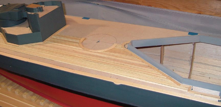

I continue planking the decks, notice the 1ft ruler, this gives you a rough idea of the scale of the ship.
You have to keep a check that everything is still in line when you join up with the midship section.
You may notice ID is not straight down either side, but has a slight curve.
42 planks to the centre line.

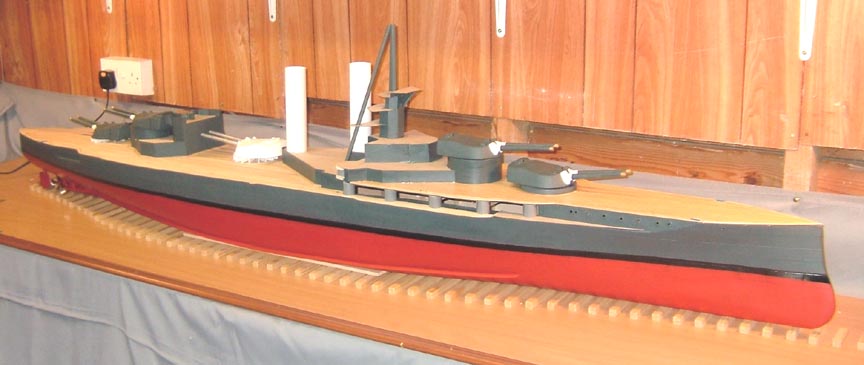

Overall view of the build so far, the rear stack has to be raised on a small platform to come level with the front stack.

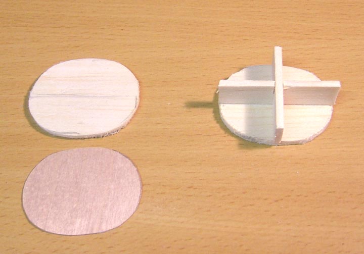

All parts cut out of balsa,
Cross section put together and placed in position.
Top and bottom fitted together.
1/64 thick ply glued on top.
Part in place under the stack.

A very short one to night.
The balsa base was covered with litho plate, this was pinned and wrapped around and then glued, the tapered section was glued in position with the base, if you look closely you can see the opposite side of the superstructure has had its litho plate glued on.
The section was painted
Now both stacks are the same height, a third coat of paint to the superstructure.
enjoy, ARH :wave_1: :thumbs_up_1:
