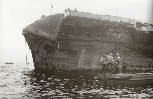

The pattern you provided is the one I'm using. In the attached photo, taken after the typhoon, that I got from the uss-bennington.org site, she appears to be painted in the MS 32 -17A (although it is difficult to tell due to wear).
Since I've already painted the hull in MS - 32 - 17A, I think I'll stick with it.

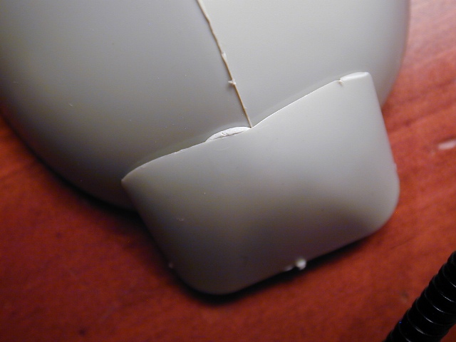

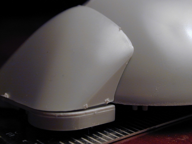

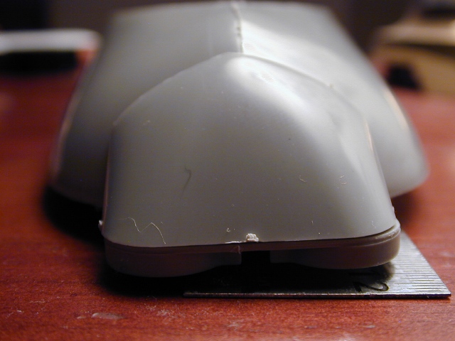

Well, thanks to grayson72, who was kind enough to send pictures of an Essex dual stern gun mount, I know what I need to build. Now I just have to figure out how to do it. Anyone have any ideas on how to do this?
I think the flat piece would be easy enough to build, and the shields(?) I think could be made out of a spare piece of PE. The support is the tough part. It doesn't seem like plastic is an option because I don't know how you would bend it to the correct shape. All comments and suggestions will be appreciated!!!

Rdutnell wrote:Well, thanks to grayson72, who was kind enough to send pictures of an Essex dual stern gun mount, I know what I need to build. Now I just have to figure out how to do it. Anyone have any ideas on how to do this?
Here's how I'd approach scratching this:
- Make the flat piece first out of sheet styrene.
- Once you have the correct shape for this find a dowel (or any round object) the same diameter as the radius on those gun tubs.
- Cut some thin strips the appropriate width for the guard rails accounting for the thickness of flat piece.
- Take the strips, wrap them around the dowel and carefully apply a heat source (hair dryer should do it). This will help the strips stay the shape you want.
- Let them cool, if you made them out of a thin enough piece of styrene you should be able to glue them to the outside edge of the flat piece you already made only do one side at a time (at this point you've only glued the strip to the outside edges and not where the guard rail curves into the flat piece at the center, leav this part unglued for now)
- Make the strips longer than you need, once the glue has dried you can trim off the extra length
- Let that side dry for a day
- Where the railing curves into the center of the flat piece you'll need to trim off the bottom of the strip the width of the flat piece (you may want to do this before glueing the guard rail to the flat piece)
- You should be able to simply bend the strip on a straight edge at the appropriate spot
- Glue the center section of the rail to the flat piece, leave this long until it dries and you can trim off the extra
As for the support structure underneath:
- Temporarily tack the flat piece to the stern of the ship where it should go.
- Mark with a pen the outline of the support structure on the stern where it should go.
- Take some two part epoxy putty and stick a glob of it underneath the flat piece using talcum powder or thinned vasiline as a release agent between the glob and the hull of the ship or it will mostly like stick there for good.
- You want the glob to be slightly larger than the intended part shape so at this point you don't have to be perfect about how it looks (you just don't want to have to add more to it later).
- Let the putty setup and become hard, once this occurs you can remove it from the hull, now you have a perfect fit to the stern for the part you just made when you need to permanently attach it to the hull
- Here's where your shaping/carving skills come in, using the mark on the stern of the hull and the flat piece as a template keep whittling away at the part until it looks like the picture and your happy with it.
It sounds more complicated than it really is. But that's how I'd do it.
