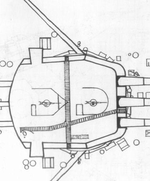

from a polish book EOW 014 - Brytyjskie pancerniki Nelson Rodney - rodney in 1940
ciao peppe
PostPosted: Tue Aug 21, 2012 2:01 pm
Posts: 637
Location: England
Thanks for that Peppe. I should be able to fabricate something similar from plasticard strips.
