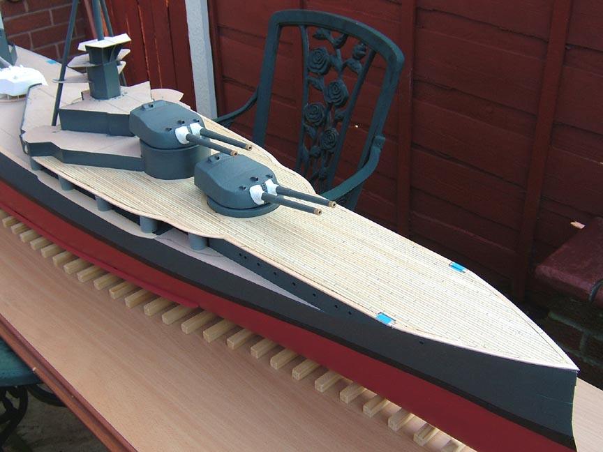

Hi Guys, still planking the deck, but a few other things besides.
Looking like a space ship the deck sanded, marked out and treated.
Back in position.
You can see the camber on the bow
I have cut the casement gun protections and placed them in position, these were cut from plastic water piping.
When you are cutting the margin planks, cut them larger and let them overlap, you can mark a better angle on the corners.
You can see the angles, the long section over the centre of the deck has been slightly bent to allow for the deck camber.
We start again on the stern, straight edge on centre line, margin done round #5 turret, timber cut and glued. A little tip, when you have all those pies, cakes and cookies save the little tins they come in, handy for putting glue or paint in, or washing out brushes.
When you have planked a section, have some weights handy to put on top to hold it down for a while.
This is the finish I am using to treat the decks, seems to work for me.
enjoy, ARH :wave_1: :wave_1: :thumbs_up_1:

I continue planking the decks, notice the 1ft ruler, this gives you a rough idea of the scale of the ship.
You have to keep a check that everything is still in line when you join up with the midship section.
You may notice ID is not straight down either side, but has a slight curve.
42 planks to the centre line.
Overall view of the build so far, the rear stack has to be raised on a small platform to come level with the front stack.
Simple but effective.

A very short one to night.
The balsa base was covered with litho plate, this was pinned and wrapped around and then glued, the tapered section was glued in position with the base, if you look closely you can see the opposite side of the superstructure has had its litho plate glued on.
The section was painted
Now both stacks are the same height, a third coat of paint to the superstructure.
enjoy, ARH :wave_1: :thumbs_up_1:
