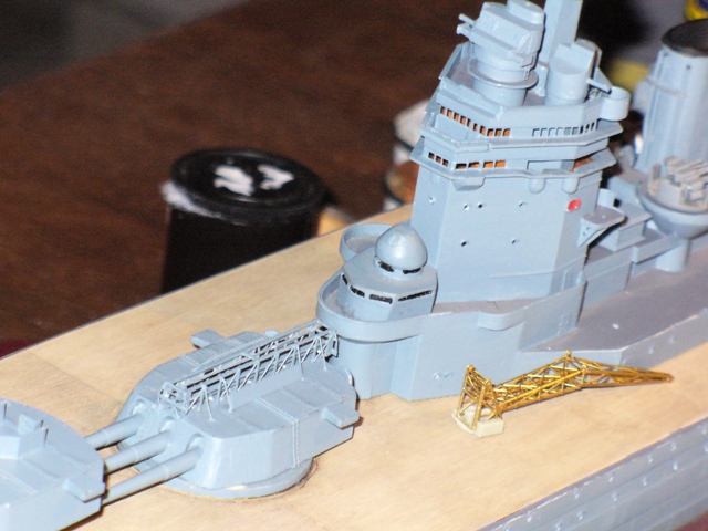

Just a single picture to show a little of the progress with my 1/350 scratch built Rodney.
I'm more and more amazed how badly documented her configuration on May 27th 1941 was (in my view her 'finest moment', when she pounded Bismarck into a blazing wreck), all I can do is just arguing and guessing what had been already installed or removed, and what was to be added later in her life.
The catapult is completely scratchbuilt from pictures, the aircraft crane was of almost the same type as installed on the Repulse, and I am going to use one from the Trumpeter kit's PE set with some small modifications and additions. In due course I will supply a complete list of the sources of the parts I used, but 90% or more is really built from scratch. The pom-poms you see are from Tamiya's KGV, I will certainlty replace these with better detailed parts later on.
People keep saying to save my time as a kit will surely arrive in due time. They might be right, and when that happens I will model her again in her spendid camo scheme, but this current model wil be in AP507B medium grey, showing all detail to good effect.
