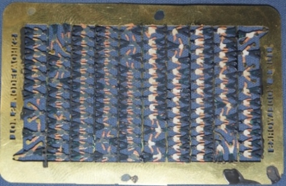

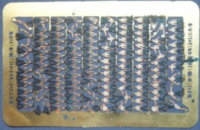

Update 126
Thanks Abram and Christian, I was just curious how he did it because I am planning on suspending a plane just off the edge of the flight deck on my model, but that’s way down the road, so I have plenty of time to think about that.
And Christian, you are more than welcome. I’m glad I could help. It helps repay, in a small part, for all of the help I have received on this Forum.
So, I decided that I am probably going to use the figures from Tom’s Modelworks at places in and around the hangar deck openings, and on the bow and stern. In any case, they had to be painted. I used enamel paints including Model Masters’ Ensign Blue for the pants and hats, Model Masters’ Intermediate Blue for half of the shirts, Testor’s White for the other half of the shirts, Testor’s Light Tan for the skin and Model Masters’ Flat Black for the shoes. The advantage to painting your own figures is that you can paint a front and a back. On the front I painted a “face” and on the back I painted “hair” using a brown mixed with the black and light tan. This is not a diverse crew. It’s a simple one. I even opted for just whites and light blue tops thinking if I needed to change one or two, I could do it on the fly.
I think they came out OK and so I think I am going to be having some big time fun in the next few sessions.

So how "tall" are these guys? :thinking: Dusted off my slide rule, put on the reading glasses, and figured they are about 13/64 of an inch. Am I close?
(... IF they are tall sailors!)

Wow Cody! A slide rule? I learned to use one way back when. We've been looking for dad's and the only one we have been able to find is a circular one, which is cool, but I want the real McCoy too. I wonder how many of today's engineering students would even know what it is?
13/64" = 0.203" is real close. Using an Engineer's scale, I measured them at between 10 and 11 on the 50 scale, so they are between 0.2" and 0.22". This would put them between 5'9" and 6'5" tall, which is what they should be. I still think they look kind of squatty. I guess they are just big boned. :big_grin:
