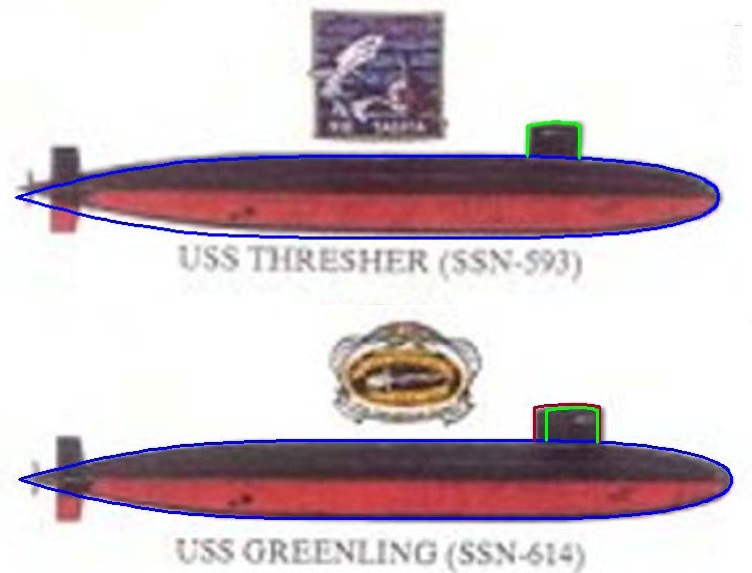

To get the large sail dimensions, I used the print. Below are 2 images from AutoCad. The top image shows the print scaled so that the hull length of Thresher matched the length of the plans. Note that the sail from the plans matches the size and location of the print nicely. The bottom image shows the same scaled print but realigned so that the print was aligned with the hull of Greenling, which was modified by adding the 13’9” to the “pipe” section of the hull. Note that the print length matches the modified plan length spot on. Also note that the sail of the Greenling on the print is clearly larger and moved slightly forward of the Thresher sail.
Assuming that since the print was accurate in the hull lengths and Thresher’s sail that it also accurately portrayed Greenlng’s sail I traced the sail on the print onto the AutoCad plans.

After scaling the photo, I moved it so that the upper forward corner in the photo matched the tracing. The results as you can see are pretty darn good. Note that the Permit sail is added for comparison in size and sail plane location only and is aligned so that the aft ends of the sails are aligned, and does not therefore show the relative location of the sails. You can also see the sail plane sections that I developed from the photo.
So, using this method, and what I would normally call BPJ for Best Professional Judgement, but since I am by no means a professional at modeling or naval architecture, I’ll call it BMJ for Best Modeler’s Judgment, to determine the sail width, I came up with the following dimensions for Greenling (and all other large sails):
Thresher/Permit Class LargeSail Sizes
Length: 26.85’
Height: 13.90”
Width: 4.76”
At 1/350 scale, the dimensions would be:
1/350 Scale Thresher/Permit Class Large Sail Sizes
Length: 0.71”
Height: 0.48”
Width: 0.16”
Ii have no idea how accurate these really are, but it is the best I have come up with. If you find something better, please let me know. In the mean time, here are the results of using the dimensions provided. The first image is of my “model” sail from roughly the same perspective as the Gato photo above. The second one shows it from various perspectives, and the last one shows the entire ship in it's rough state and "painted".

You are most welcome krgf15, but I must apologize as I just noticed a small error. The height of the large sails (according to my estimation method) is 14.2' high instead of 13.9' like I reported, which is the height of the smaller sails. At 1/350 scale this would be 0.49" instead of 0.48". Not even noticeable, but what's right is right. :smallsmile:
