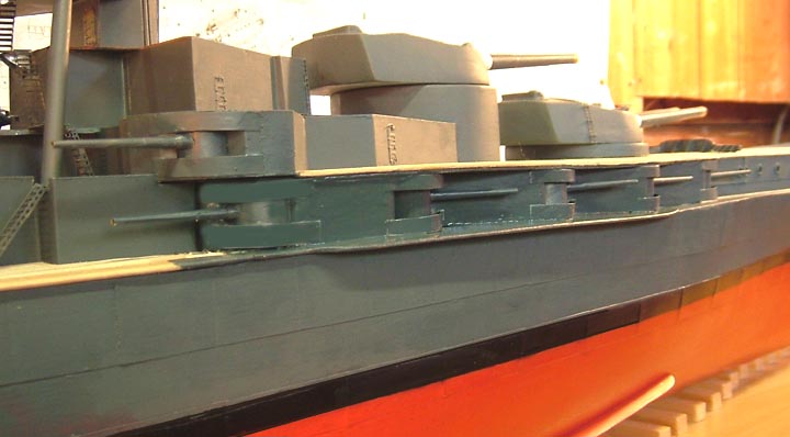

Hi Guys, I am going to show you how I fit my casement guns.
This is an overall shot of the ship, but you can see where the casement guns are to be fitted, 7 in all on this side, one at the stern, but that will be later.
The barrels were made by Steve Nuttal and are fitted in to some round plastic piping.
In the picture on the second gun, you can see a white piece of plastic, this is cut around the piping top and bottom, and glued in place, this allows the gun to move round and not be static.
The first gun casement has been fitted out, and covered in litho plate,

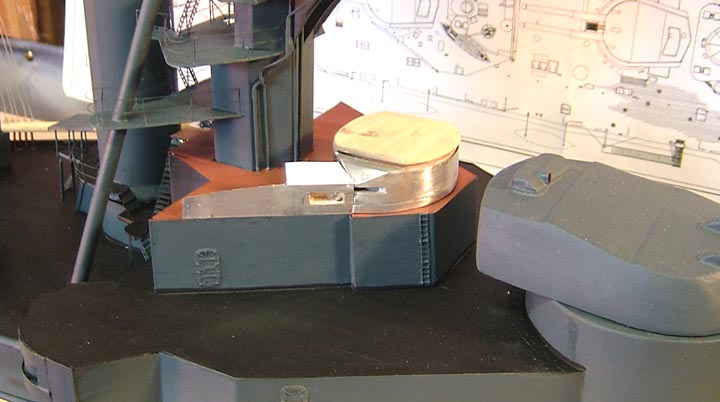

Hi Guys, Just a few pictures of the finish of the casement guns.
All guns fitted, 5 below and 1 on the next deck, just the blast bags to fit and the curtains.
A close up of all the work, if you look at the very 1st picture on page 1, you can see what I mean by the curtains.

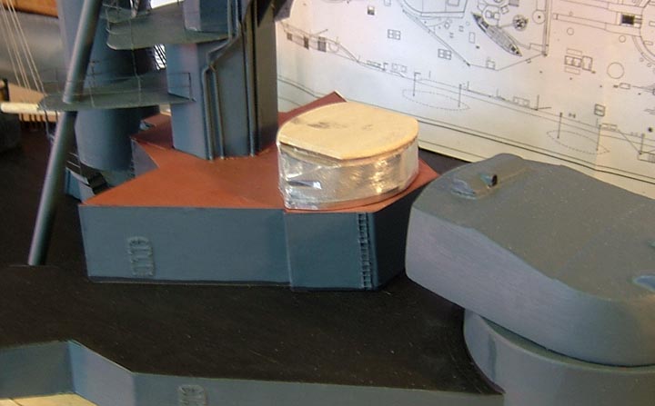

 Post subject:
PostPosted: Sat Nov 19, 2005 5:43 pm
Posts: 2557
Hi Guys, just a small one tonight.
This is the timber store, it is located on top of the blacksmith shop, this was built of litho plate and strengthened with brass rod underneath, it is filled with lengths of timber,

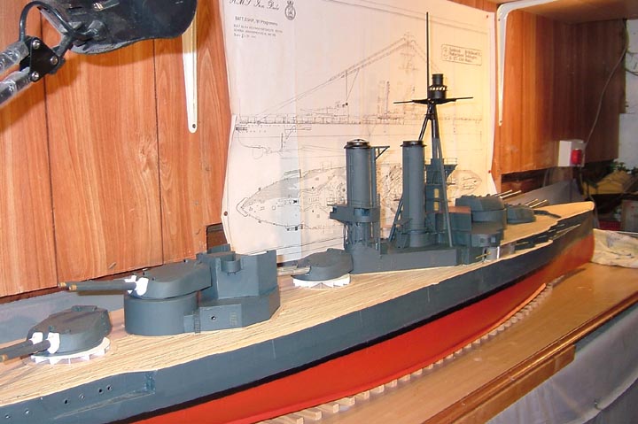

Just a few photo's tonight.
I have been looking at the decks, on some RN ships steel decks were scrubbed, polished and oiled, giving a black look, so 2 decks have had that treatment,
I think it gives a better look to the ship. In this picture the superstructure now stands out from the deck, instead of all looking the same.

I never let people suffer to long, :lol_3: :lol_3: so for Tommy L the 2 barbettes are finished except for painting. Note my chain for the anchor's
