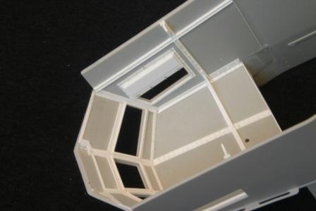

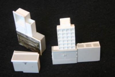

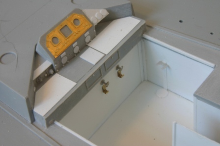

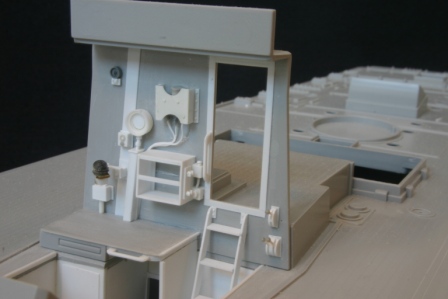

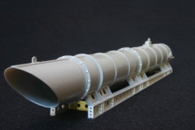

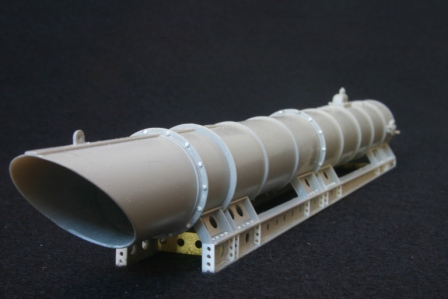

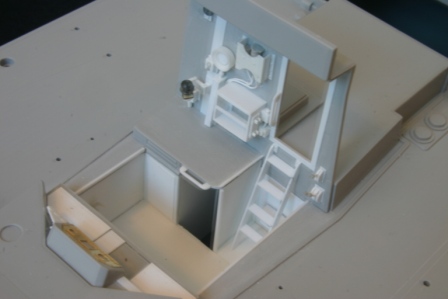

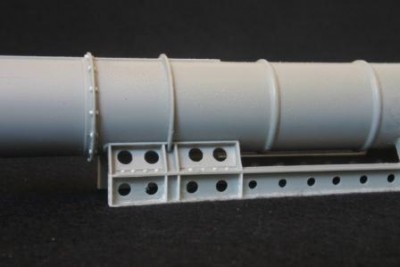

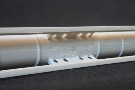

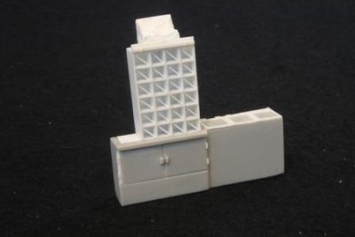

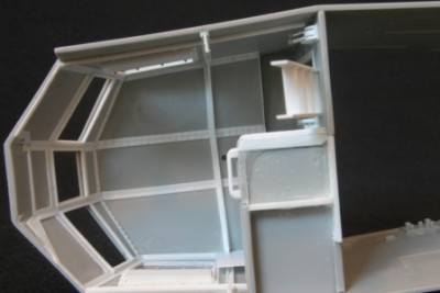

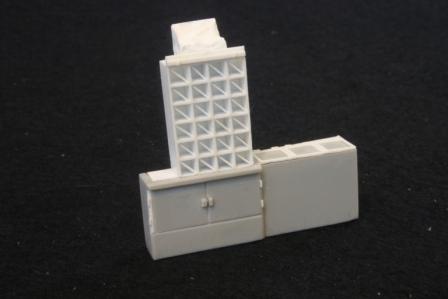

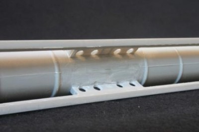

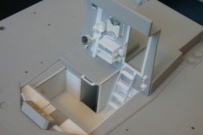

With the Italeri 1/35 Vosper out, it�s time for this page to get active again! I�m posting some photos of my build in progress. I�ve rebuilt the wheelhouse interior, adding structural framework and the missing detail from the aft bulkhead. I relied on John Lambert�s drawings and the photos in Allied Coastal Forces Vol. 2. The boat I am building (234) had the steering station removed. I don�t have photos of her wheelhouse, but Warship Profile No. 7 has photos of MTB 66 with this modification, and I felt these could be relied on for the changes. It appears that some of the engine indicators were left intact, as was the hydraulic motor for the steering control (even after the steering was reverted to manual). Storage bins, chart racks, handrails, the fire extinguisher, and miscellaneous pieces of equipment all have been fabricated and will be installed after painting. While the view through the windows and open door will be somewhat limited, I want what shows to be of the same level of detail as the rest of the boat.
The torpedo tubes were modified by grinding away the inaccurate bulky plastic between the rail mounts. I considered replacing the rails from scratch, but knew it would be tricky to get the rails and tubes to sit level as they cross the cambered deck at an angle. So instead the kit rails were rebuilt. All of the structure was thinned. The vertical bracing was replaced with thinner structure with lightening holes. Bolt detail was added to the tubes and mounts. The remaining firing gear details will be added after the units are mounted on the deck. The bridge has had most of the molded on detail removed. Once the wheelhouse is painted and installed, the bridge will be rebuilt and detailed in a similar manner. The stowage and flag lockers have been rebuilt in anticipation of this. I hope to make this area the �showpiece� of the finished model. Any comment or critique is welcome. As I will be on the road, it will be a couple of weeks until I can get to painting and closing up the wheelhouse, so I can still make alterations or corrections.
Cheers, Mike

Thats some excellent detailing work Mike, particularly the torpedo tubes, I'm doing a similar re-working myself, I was going to re-build the rails but as you mentioned its tough to get them to sit right due to the angle and camber of the deck, so plan-B, pimp-out the kit tubes!
I'm actually going a little further than you have because the layout of holes in the rails needs to be changed for the boat I'm making, MTB 84, the forward section of the rails should have 3, evenly-spaced, holes, not 4 as Italeri have moulded them, and the rear-most section needs to be altered to so I'm chopping out the sections and using sheet and strip to replace them.
It's great to see your wheelhouse detailing, it has answered a question I've had since I got the kit, how did the crew get below decks from the wheelhouse! Now I know! Have you completely replaced the Italeri wheelhouse 'well'? The floor and lower walls?
And if I might pick your brains a little more? Do you recommend the Lambert plans? I'm toying with the idea of buying a set, I think there are 5 in all including the Vickers Mk.V turret and they are a bit pricey, having never seen them outside of the small reproductions in Allied Torpedo Boats I'd be interested in your feedback before I splash out the hard-earned cash as you are actually using them.
Fabulous work Mike, I can't wait to see what comes next.

I've noted a variety of styles of rails used. I haven't really looked to see if there was any pattern to which boats had what. Fortunately, you seem to have pretty good references on MTB 84.TheModeller wrote:I'm actually going a little further than you have because the layout of holes in the rails needs to be changed for the boat I'm making, MTB 84, the forward section of the rails should have 3, evenly-spaced, holes, not 4 as Italeri have moulded them, and the rear-most section needs to be altered to so I'm chopping out the sections and using sheet and strip to replace them.
Yes, it was easier than trying to cut up the kit parts. As to the step down aft to the hull spaces, I believe I have gotten it correct, but if anyone knows otherwise, please speak up! With the wheelhouse in place, little will show of this, but I'd like to get it right.Have you completely replaced the Italeri wheelhouse 'well'? The floor and lower walls?
I can recommend the Lambert plans. The reproductions in the Shipcraft series "Allied Torpedo Boats" are pretty small and hard to work from. If you don't have it, try to get a copy of "Allied Coastal Forces Vol. II" (Lambert/Ross). It has a more complete selection, and the drawings are larger and easier to work with. I feel the book suffered from some poor editing, but it contains a wealth of info and is still probably the best published resource on these boats. Individual plans are a bit pricey, but you can get exactly what you need that way.
