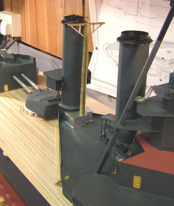

I'm showing a picture of this section of Iron Duke, I have fitted the rail close to the top of the casement, also the eyelid over the port hole.

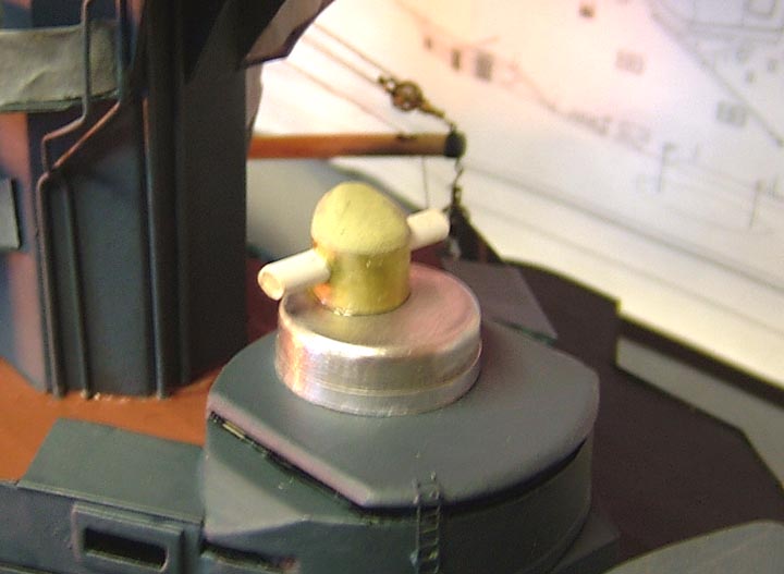

I made the cross tree on top of the Samson post, I cut into the top and fitted a brass section, this has holes drilled in it at each end that will carry a block and tackle, the bracing are made of lime wood.

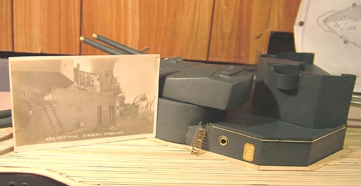

In the picture on the second gun, you can see a white piece of plastic, this is cut around the piping top and bottom, and glued in place, this allows the gun to move round and not be static.
The first gun casement has been fitted out, and covered in litho plate,

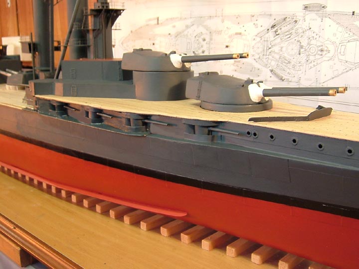

A close up of all the work, if you look at the very 1st picture on page 1, you can see what I mean by the curtains.

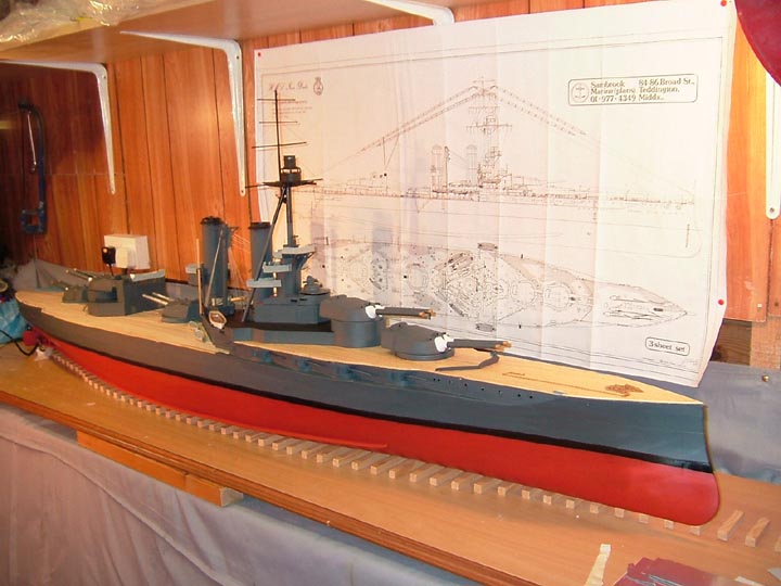

Viewed from a distance, also you can see the casement guns, they look better now the paint has dried.

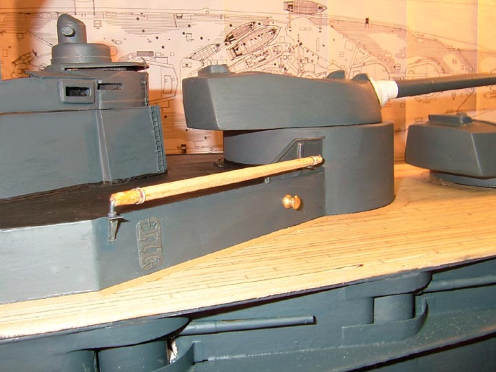

The coaling davit is fitted, it was made from 20 year old spruce, well seasoned, it was square and I carved it to shape, then made the round fittings out of brass and litho plate. The small support is made out of litho and is super glued in place above the door.

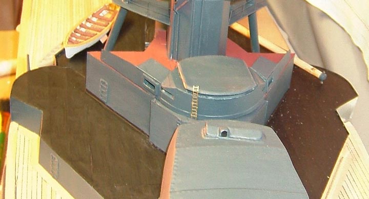

Cleats were drilled and fit either side. Also the timber brace and black landing protection, the metal treads when painted should look like a rope ladder.

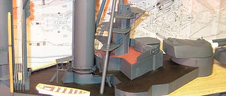

Just to show what hangs there, I have borrowed a boat from another model, it's just a little large but serves the purpose. When rigged it will be higher.

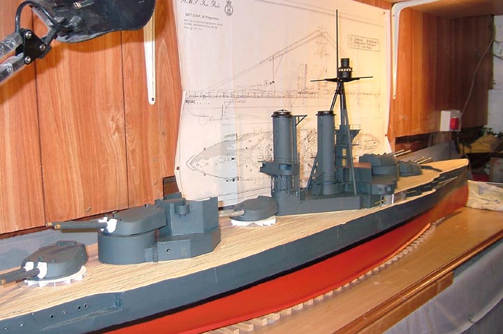

I think it gives a better look to the ship. In this picture the superstructure now stands out from the deck, instead of all looking the same.

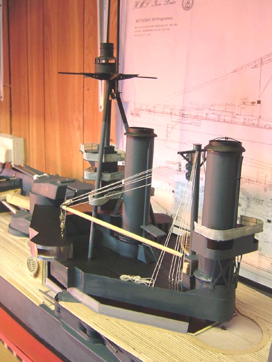

Back in place and the eyelets fitted for the rigging for the Samson post.
The rigging fitted to one side.
From a different angle, note the walkway around the funnel has been painted black.

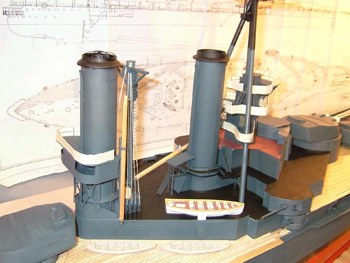

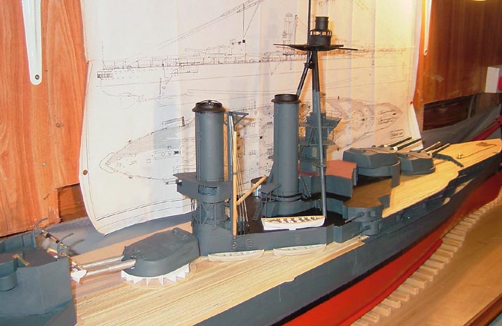

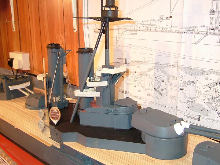

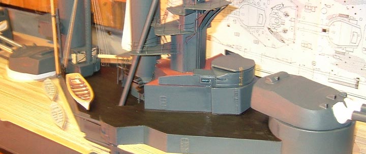

The last 2 pictures are different views of all the work, she is beginning to look better now. I like the black decks, they break up all that blue, what do you think guys.

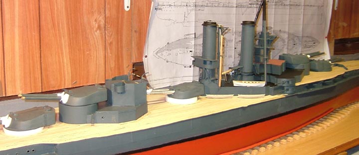

Hi Guys, A small one to night a continuation of the last post.
The rigging is finished on both sides, I used a cotton type cord, it was smeared in a wax like substance to protect it in the weather.
The button at the top of the Samson post was made out of brass and plastic, then glued in place.
I never let people suffer to long, :lol_3: :lol_3: so for Tommy L the 2 barbettes are finished except for painting. Note my chain for the anchor's
This is a double pulley block with hook. This is the beginning of the rig for the main boom, it measures 3/4 of an inch, as you can tell made by me. :lol_3: :jump_1: :jump_1: :thumbs_up_1:

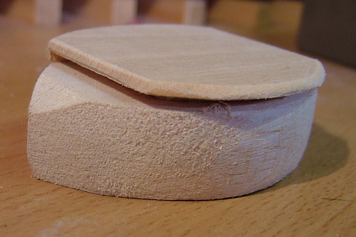

Hi Guys, After a long study of the drawings I've worked out how the battle bridge should look. :jump_1: :jump_1:
I cut the base, middle section and top out, the last two were made of Lime.
I glued all sections together.
The bottom section I've covered in litho plate.
Placed in position, also a low look out position was cut on both sides.

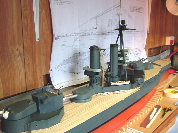

An overall shot of the work, still only placed in position, still some pieces to add.

Hi Guys, I am rigging the large boat boom tonight.
First I had to make more pulleys, this time only single ones. The Samson post had to have a fitting made to fit around the top pulley, this is the starting point of the rig.
Seen from mid ships.
Viewed from bow section.
This gives a clearer view with the superstructure lifted off and turned around.
As you can see there are 2 separate lines, one controls the lifting of the boom, the other the lifting of the working end, the hook.
The ropes on the deck will be attached to pulleys and capstans later, when made.

Hi Guys, I have been doing the sights on the battle bridge, handrails and range finders.
The very bottom part is the bottom cut from a WEM tin of paint, with a rim of litho plate super glued to it. On top a brass tube drilled though and a piece of round plastic flattened slightly and pushed through.
Next some Milliput mixed together and shaped into a dome, also the end of the sights filled in.
Painted and fit in place.
Handrails fitted on command bridge, this is were Admiral Jellicoe stood inside at the battle of Jutland.
Three sections of plastic cut to shape and a piece of brass fitted though one section.
Sights painted and fit in place.

Hi Guys, A little rigging and boat slinging.
The cross trees are made from brass rod, filed to shape. The mast is brass rod and is drilled in three places.
My rigging is a thin braided cord slightly metallic in gold, painted matt black.
I have rigged the boat to the davits, you can see the cord better in this picture.
Everything tide down, the boat has only been coloured in on these photos, I painted them today. Blue outside, white and tan inside.
Bow shot.
Stern shot.

Hi Guys,
Some more rigging on the fighting top.
A section of guardrail made out of plasticard, a boom support made out of litho plate.
A view of the work to date.
Guardrail painted and capstan for boom fitted.
