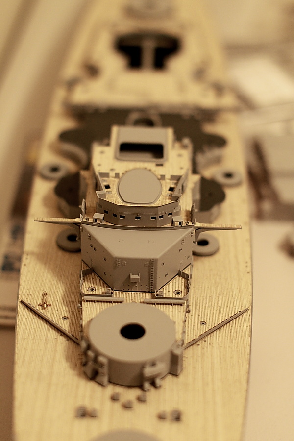

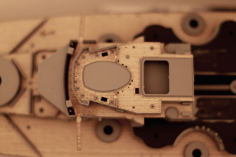

been busy continuing with the bridge tonight.
One annoyance is the blocked door way on the section of superstructure on the bridge deck. I've opened this up. This leads to a door entering the bridge shelter deck and a stairway leading to the next deck. So while no detail would be seen it still wouldn't be a blocked door.
the open door way here is blocked on the kit. This doorway doesn't open up into either the bridge shelter deck or the chartroom but a small passageway. On one side a door to the shelter deck and the other the stairway leading up to the next deck.

From what I'm seeing there should be doors into the bridge from both sides in the jutting (somewhat) triangular edges of the bridge area just kitty-corner from the doorway cutout. The kit doesn't have them.
Does the PE set include them by chance?
-Jason Channell

Thanks Channell, yep both the AOTS and the SHipcraft books show this clearly. I bit of plastic card and sorted :)

just read the footnote of your post channell, missed it initially. No the PE set hasn't got them either. I've got some 0.5mm plastruct sheet which will do nicely for it. Luckily Trumpeter actually made this section correct in the first place, even with out the door. The Tirpitz didn't have that jutting out section so I presume the entry into the bridge shelter deck was through the night watch shelter deck - what the open doorway leads too. On most of the plastic kits both 1/700 and 1/350 this section is moulded incorrectly - can't comment on the revell kit but I know the tamiya 1/350 is wrong and has the Tirpitz bridge.
Von der Tan's 1/100 model shows the door leading into the bridge shelter deck

How are you planning on fixing that bridge door? Looking at the model piece, there doesnt seem to be enough surface area to make a tall enough door. Then again it could just be my inexperience with ships.
Perth_shipyard
Posts: 677
Joined: Tue Dec 08, 2009 11:15 am
Location: Fremantle Western Australia
Re: 1/200 Bismarck by trumpeter
Post by Perth_shipyard »
Ill just be making them out of plastic card and strip.
The height is correct. The shelter deck is lower than the deck outside, only by a step but as you would enter the bridge shelter you would step into and down.
