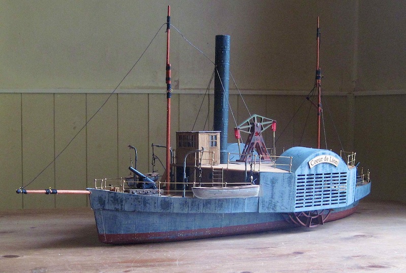

Not an ironclad as such, USS Coeur de Lion was a lightship tender loaned to the Navy Dept. in 1861 and converted into a gunship. She patrolled the Potomac and other rivers in Virginia, destroying or seizing several ships attempting to break the blockade. She also engaged two forts, forcing one to surrender. She also had the distinction of towing Thaddeus Lowes's balloon barge, the George Washington Parke Custis, considered to be the first "aircraft" carrier. My model is 22" in length (1/55 scale) and is inspired by a paper model designed by the talented paper modeller, Magnus Morck, now sadly deceased. I would describe all my models as stand off scale, and this is no exception, it is radio controlled, steered by 2 independent motors and although I have altered/ added items as I see fit, I hope I have remained true to the spirit of the original ship. Sharp eyed will notice that the davits have been moved forward, this makes the removal of the superstructure easier. I have added stanchions/rails - these are not obvious in the photo of the original, but I have difficulty believing that what was once an ocean going ship would not have guard rails, especially on the hurricane deck. The hull plating is an indulgence, I suspect the original was wooden hulled, yet I am unrepentant! The walking beam is operated by a servo that has been modified for continuous rotation, this is Y'd into receiver output for one of the paddles and although the response is best described as sort of proportional, it does allow the beam to rock at a dignified rate. I am also building the balloon barge to the same scale and hope to tow it around my local pond. If everything works out I should be able to raise? and lower a helium filled balloon using another servo converted to act as a winch in the barge. We'll see.

That's really beautiful work. Love anything with a paddle wheel!
It's really odd that you posted this today. Earlier this morning I was thinking of the George Washington Parke Custis and wondering what ship would go with her as a towboat. I guess that I had known that Coeur de Lion towed her, but I'd forgotten it.

Great model. Paddle wheels rule! How did you arrive at that scale? I am also curious as to what the hull looks like below the barge. I can't find any info on that. Could you post a pic?
