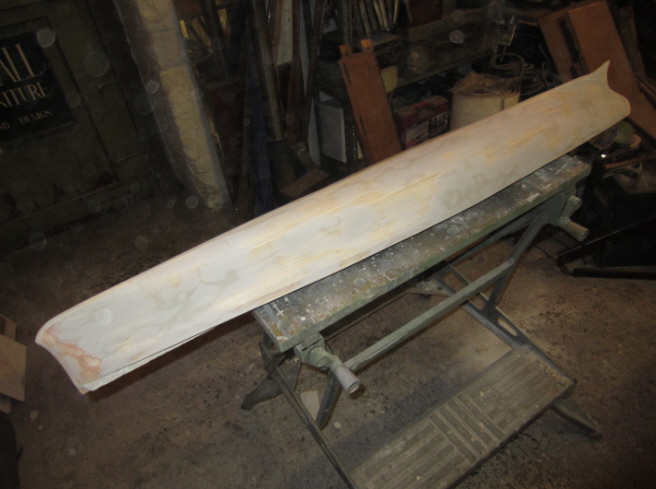

After completing the planking process the plugs was sanded down with quite course sand paper to remove blobs of hard glue and other raised areas.
The external spines on the backing boards were temporarily removed and the two plug halves were offered up to each other. Four holes were drilled so they could be bolted together and they were sanded so that they matched together well. They were taken apart again and the wooden spines re-fitted.
One coat of cellulose varnish was applied to seal the surface.
At this point the plugs still looks pretty rough. Next a thin layer of car body filler was spread over each half of the plug. I used a flexible metal spreader for this to keep the layer thin and consistent. When set, this was sanded smooth before the first coat of (yellow)filler primer was sprayed on (from a spray can). At this point you start to see the real shape of the hull and you realise the hull lines in the plan must be accurate as they show up all sorts of interesting detail, for example the bulge in the hull to accommodate the turbine room, the upward curve of the keel (forward of amidships) and the cut outs for the forward torpedo tubes. About four coats of the filler primer were used, sanding down and filling between each to work up a smooth surface.

File comment: The first of four coats of filler primer start to build up a smooth finish. Small marks and scratches are filled between coats.
File comment: The plug halves are now smooth ready to add the fine detail.

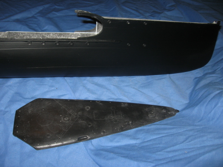

I wanted to get as much detail as possible moulded into the hull. As V105 was designed as a "wet" model from the outset, I did not want bits "dropping off" after prolonged sailings, when adhesive started to fail! It also seemed sensible to add the detail at this stage (the plug). Handling, measuring and locating the detail into the plug was so much easier than working on a full hull, as I could handle one plug half at a time and clamp it down to the work bench. It was also possible to lay the plug halves along side each other and mark across locating positions for detail like the port holes.
When the port hole positions were marked, a metal template was used to control the drill bit when each hole was carefully drilled, with a newly sharpened bit. Short sections of brass tube were then inserted into each hole. It's not shown in the picture but short lengths of plastic rod were then inserted to the correct depth to block the tube. The rigoles (eye brows) were formed from soft brass wire wrapped around the correct size of drill bit shank, and snipped off with side cutters. CA glue holds them in position.
The same self adhesive aluminium foil was used to mark location positions for the prop shaft "A" frames. This will be seen in subsequent pictures.
At this time I also turned my attention to the fore deck. A template was taken from the plans and the basic shape for this was cut and carved (initially with the trusty spoke shave) from a piece of lime (bass wood). Having smoothed and prepared the surface of this, I again added as much detail as possible, deck lights, plating, chain runs, location positions for the gun, breakwater etc. The chain stoppers were moulded in completely too. This fore deck plug was used to manufacture a silicon mould, which will be supported in a glass fibre cradle (not shown here) when in use.
File comment: A template tool was used to drill the port holes accurately. The rigoles (eye brows) are formed from soft brass wire.
File comment: All the exterior hull detail is now in place. The port holes have yet to be blocked off.
File comment: The fore deck plug is here seen complete with detail. The red oxide primer makes a good surface for the silicon mould.
File comment: The silicon mould for the fore deck, having been removed from the (master) plug.
File comment: The silicon mould for the fore deck (close up). The pale colour of the silicon does not show up the detail well.

The split hull mould has a wooden frame type cradle. The whole cradle is in two halves as well, so that when the mould is split the cradle splits too, each half being permanently fixed to the mould. The open framework means you can get easily to the wing nuts to split the mould. Again it's good to be able to clamp it all to the bench so that when laying up the GRP, the whole thing is not wobbling about.
The close up of the interior of the mould shows the port holes and eyebrows in reverse.
I DID NOT TAKE PICTURES OF THE ACTUAL LAYING UP OF THE MOULD AS IT'S AN UNBELIEVABLY MESSY BUSINESS, AND I WOULD HAVE CERTAINLY GOT RESIN ALL OVER THE NEW CAMERA! I THINK THAT'S WHAT LEAD TO THE LAST CAMERA MALFUNCTION!
The laying up was straight forward, (black) Gelcoat followed by two layers of CSM (chopped strand mat). The hull came out of the mould very easily, no release agent being required for silicon moulds.
The end result a very nice and accurate 1/48th scale V105 hull and fore deck, ready to start building. The pictures show the hull and fore deck after the 20mm of waste have been carefully trimmed from the edges.
Next post "Fitting the fore deck and bulkhead".
File comment: The fore deck mould in it's GRP support jacket.
File comment: The hull mould in it's support cradle.

File comment: The first 1/48th scale V105 hull and fore deck out of the mould. All the effort pays off.
File comment: The first V105 hull is trimmed down to the deck edge ready to start building.
File comment: The detail on the hull exterior has transferred nicely from the mould. Sorry about the dusty finger prints!
