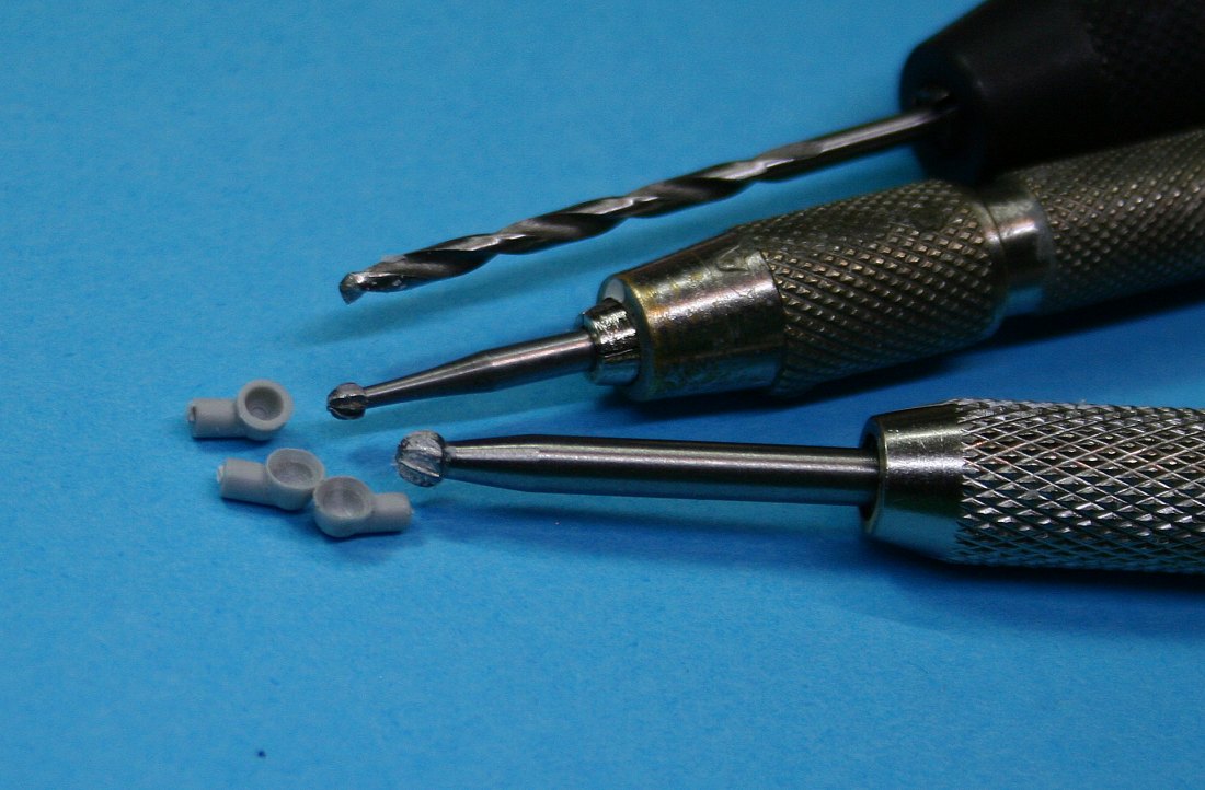

The vents in this old kit were actually a fair starting point --alas I had already raided this kit for the Novik build...! :heh:
so I searched though my stash and came up with a Seals model kit of an IJN cruiser that rendered suitable vents as a starting point...
These featured a rather ugly flash/moulding web
which had to be removed with a blade.
the wall thickness of the vent and the mouth depth was not to my liking
so I proceeded to deepen and the thin the edges using various burr tools held in pin-vices.
Zhemchugs vents like those of Novik were not perfectly round nut a gentle oval.
the thinned vents were squeezed from behind using some Jewelers pliers to achieve the desired shape

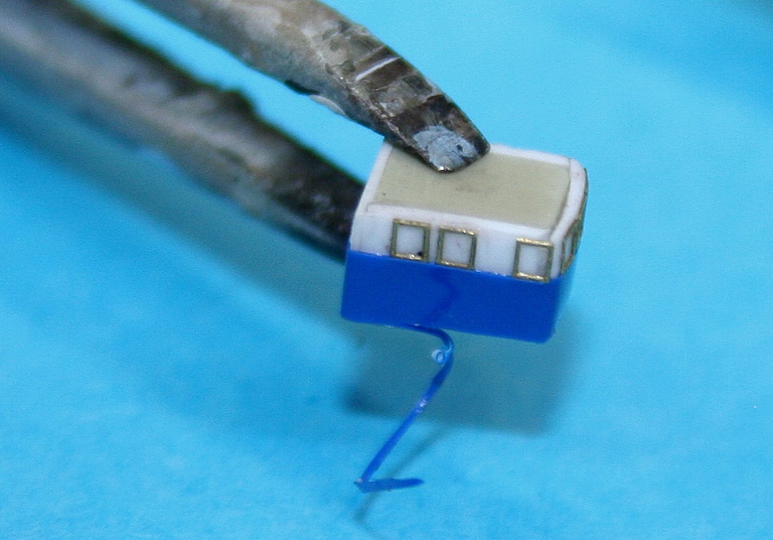

The pilot house that sat above the conning tower on the brdge deck was scratch built of styrene sheet around a block of resin
Window frames were made of suitable pieces of PE Ladderstock( WEM Koenig ! )
The lower level was brought out to window level using a wrap of vinyl tape ,
cut to size after application and sealed with CA
upper rails were fitted in place

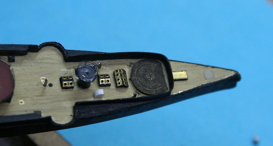

I must congratulate North Star for their excellent cable reel sides--finer etching I have not seen yet!
I improve them by cutting away the non-correct cross-braces--and make life very hard indeed for myself as it all hget wobbly and fragile!
Its all getting a bit more interesting nw with the addition of small vents made of solder wire, compabnion way hatch made of styrene block etc etc etc
Hull side the addition of the anchor hawsepipe covers and TT tube hatches are on
Alarmingly ( for my sanity !!) I had 5 attempts at making this compass platform ... each taking nearly 1.5 hrs...!!! :mad_1:
The rails are WEM ultrafine ( they are!) - with a small piece of stretched sprue across the ladder access so as to seal the oval -the floor is white glue, whilst setting I dropped in this brass cruciform cut from 1/350 handrail so that it sank in flush so as to give the base a bit more solidity.
When the white glue dried clear I lightly coated the underside with thin CA and then propped it all up on a piece of styrene rod-- which was then placed into a pre-drilled hole on the ship!

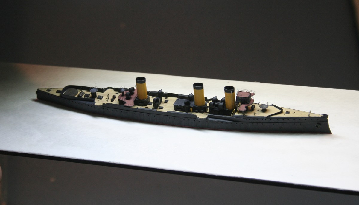

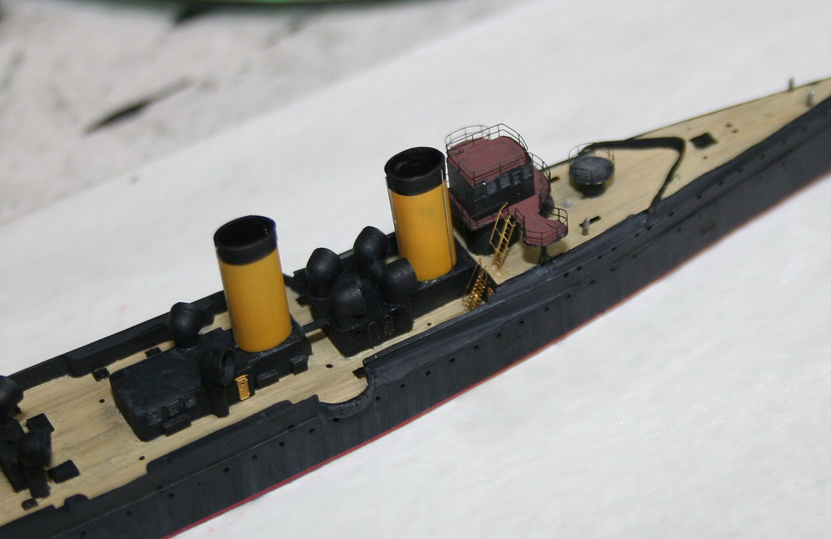

The ship is now mounted--which should prevent further handling damage-- funnels are up
( I prepared these when I built Novik).
The black demarcation was done using decal stripe--sharper than I can paint...
Lots of small vents are now being made of solder wire and installed
The vexed platforms!

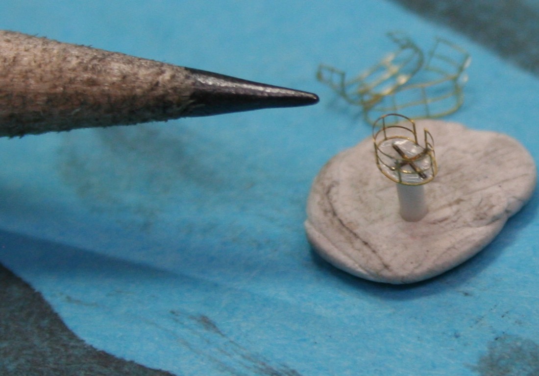

I spent a surprising (!!) amount of time on making the fwd and aft searchlights

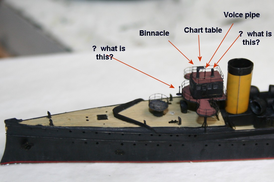

the upper bridge had some attention--according to photos and plans
( The Binnacle bowl will get a lick of 'brass' paint...
however there are some bits I am unclear about
ideas anyone?

I think the "?" aft of the compass could be the search light control.
 Post subject: Re: 1/700 Zhemchug
PostPosted: Sat Mar 09, 2013 4:15 pm
Joined: Mon Jan 10, 2005 2:08 pm
Posts: 942
I like the idea of search light control but I don't know if central control for search lights existed at that time. But could it be "антенный ввод" (antena terminal) which was present on Boyarin's bridge? As for the "whatsit" in front of the chart house... Could it possibly be an engine room telegraph?
Boyarin
35 - compass
36 - voice pipe,
51 - engine room telegraph,
52 - антенный ввод (antena terminal).
