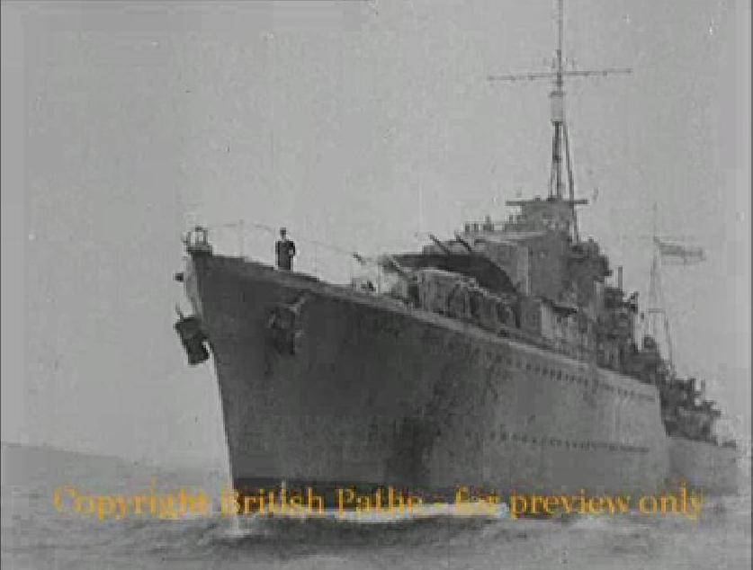

At the time of 'Narvik' the Cossack was definitely AP507B overall, plus still wearing pennant F03, even in May '41 this was still the case:
These stills are from a Pathe film made regarding the sinking of the Bismarck, but were possibly taken already on the occasion of the Altmark incident.
I believe Cossack retained this scheme for considerable time, even after taking over the squadron leader rol from HMS Afridi. Note also the forward funnel, being entirely AP507B, no black painted top part. Only on pictures of Cossack while sinking it is evident she wore the black funnel top, whilst having a colour scheme of AP507A hull with AP507C superstructure. The pennant numbers are not visible then (below the waterline already) but I think would have been deleted by then.

Given that the location of the film's doctorings on the hull correspond with the locations of shell hits suffered at Narvik, and the twin 4.7" at X position, the stills from the British Pathe film must show Cossack returning from Narvik. They certainly show her Narvik appearance.
At the time of the (earlier) Altmark incident she was acting as flotilla leader. At that time she wore no pendant number and did have the leader band at the top of the forward funnel -see various moments in this film:
http://www.britishpathe.com/video/briti ... ms+cossack
Tribals changed their Flag Superior from F to G in 1940 from late spring/early summer onwards.
