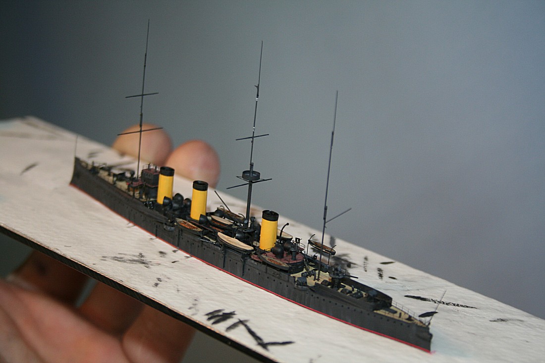

After the tedium of making wire davits and ships boats ...the fun of erecting masts could commence !
Zhemchug carried outrageously tall masts--three of them.
I have devised a method of enuring the masts all set perpendicular whilst the slow setting epoxy and CA are setting
Simply suspend the ship upside down--the masts dangle nicely... :heh: easier than trying to keep them in position with the ship upright!!-- let gravity be your friend! :thumbs_up_1:

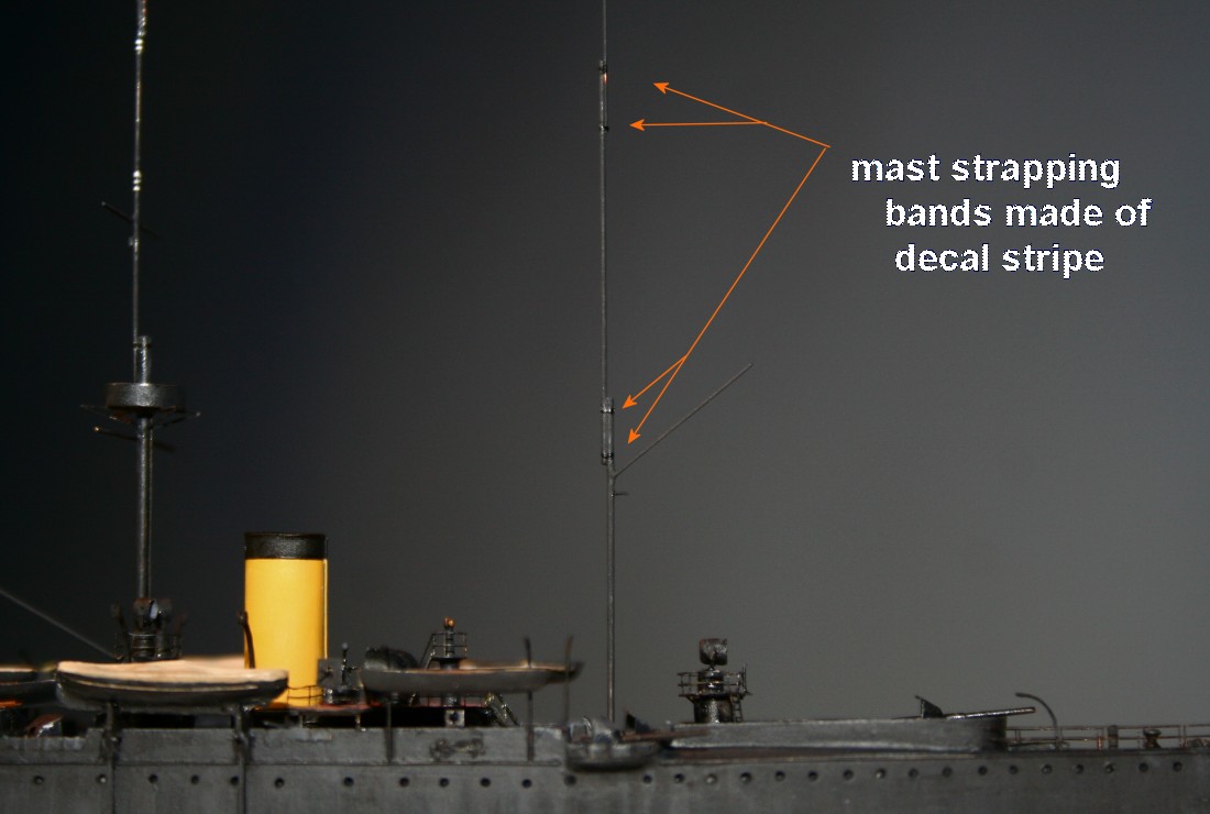

The ship carried identifying stripes on her main mast--I made these using very thin decal stripes--black thin on white broad....
The various sections of the masts had the strapping simulated with decal striping--makes just enough of a bump to look interesting....

back from the ( rigging ) wilderness....! :wave_1:
she is complete at last!- there was a lot of very fine rigging to do on some very very skinny masts...
( :mad_1: :Mad_6: :Mad_5: :mad_2: :censored_2: :lol_3: )
- full photo coverage will be in the gallery in due course.
meanwhile..... here are a few taster shots....
onwards to the new project :thumbs_up_1:
Thank you all for following this build--a link to the gallery will be posted when it appears there ....
Jim Baumann

Jim,
Are the flags printed paper? How did you get them to flutter so naturally? I tend to use white glue + paper but it tends to appear overscale in 1/700.
- Chris
