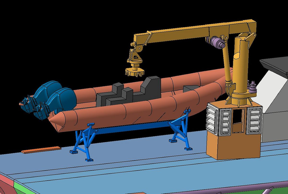

File comment: Hero's can carry two 8m Zodiac H753s, powered by twin 200hp Evinrudes. The crane has a special head to engage a grab structure in the boats (not shown yet)
