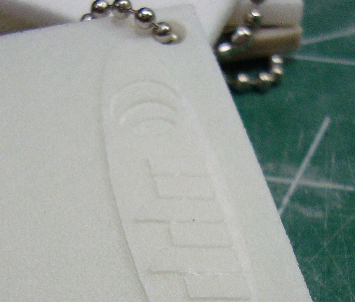

OK, I'm getting ever more hopeful about fine detail parts. I haven't heard back from Nelson, maybe his source isn't publicly available. But I did contact another modeler, TBowman at RC Groups, who has been getting some incredible parts for his large RC scale-sail HMS Scorpion:
http://www.rcgroups.com/forums/showpost ... tcount=128
Those parts come from APP (American Precision Prototypes), and are off of a true SLA machine. Quick reminder, there are several types of 3D Printing commonly available (and others, not so common):
SLA: Stereolithography... a laser is steered around on the surface of a pool of liquid polymer, curing the stuff as it goes. Provides the finest parts.
Inkjet/Polyjet: Just like an inkjet head, but either a photopolymer or a support wax are applied in layers by a printhead. Each completed layer is hardened by exposure to UV light. My experience- depending on the machine and material, can be as bad as FDM (below), or pretty fine (Shapeway's "Frosted Ultra Detail").
SLS: Selective Laser Sintering: A laser is steered around on a box of fine plastic powder (often nylon). Reasonable resolution, gritty porous surface. Often the lowest cost for big parts, needs sanding and filling.
FDM: Fused Deposition Modeling. Squirts out strips of molten plastic, like building parts with a hot glue gun. The worst for resolution, might be ok for 1:6 scale wicker chairs.
So I got a sample set from APP of a bunch of their materials, some photos below. I wish they had printed round or angled parts... surfaces square to the machine tend to come out the best, but the real test for the "jaggies" is a rounded surface.
Nevertheless, the Acurra Xtreme SLA material that TBowman used looks fantastic... really, no visible strata, virtually like an injection molded part. This has promise.
APP does have a $300 minimum... reasonable for a big ship model, but a pain if you're ordering small lots here and there.
File comment: Acurra Xtreme SLA sample... very nice!
File comment: FDM example... too gnarly for me.
File comment: SLS nylon powder... you can see the grit in the foreground.
